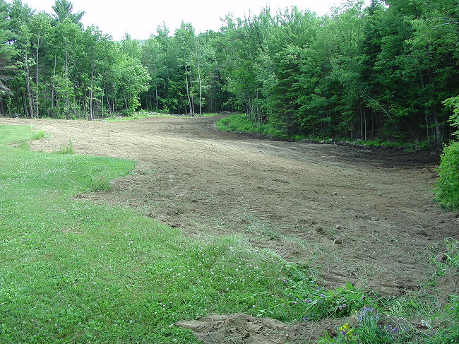

I am thinking that a basic, 4WD tractor w/ a FEL would be multi-faceted. With a Woods RFM, we can address the extensive cutting needs. The RFM is easy to remove so we can then use this tractor as a supplementary wheel barrel to the B26 for rock work and materials handling. I also expect to rent a PHD in our distant future which could be operated by this tractor as well.
We have time to consider all options. I wanted to get a start on planning given the eventual cost to own and operate two separate tractors. I decided that I do not want to remove and re-attach a backhoe for several reasons. That decision necessitates the need for a second tractor. *Used* is the affordable solution. 4WD is essential. We have slopes and some rough terrain that became problematic for our previous 2WD, 25hp tractor.
Presently, I cut 3.5 +/- acres of grass on a 42" riding mower. I'll continue to do so for 2 more seasons - maybe 3 more seasons. But, as we add more open field each year [up to approximately 7 acres total], I have to move up to a mower that is larger and faster. Here's an image of the most recent clearing. I'm hand raking it before I seed. There are tons of small rocks at, or just below, the surface. We try to clear about 1 acre each year. It's a manageable size to clear, rake, and pay for. The clearing goes further to the bottom right than seen in the picture.
