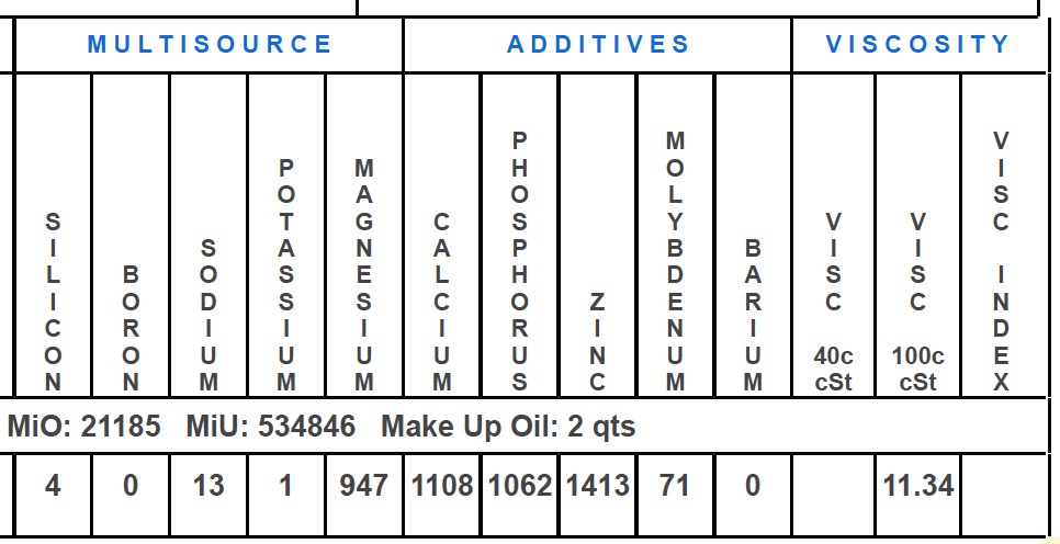

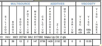

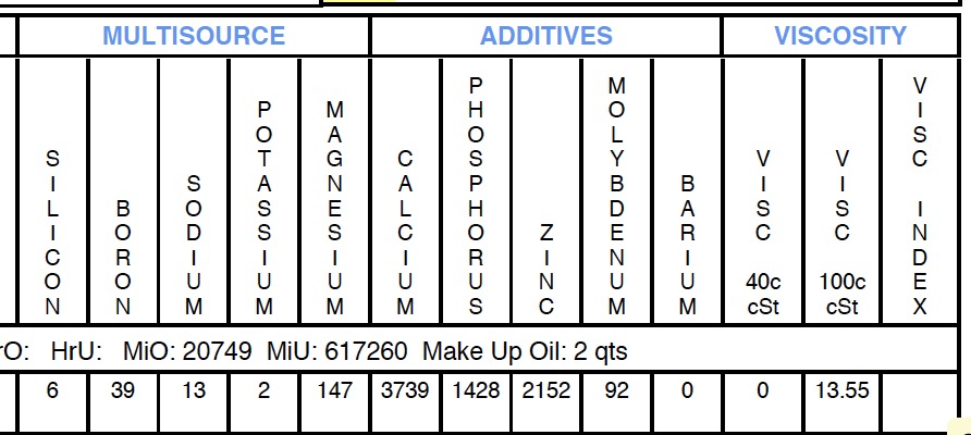

Many of Schaeffer's HDEO oils have significant levels of zinc. Here are results of levels from 1) 15w40 2) 10w30 3) 5w40 from oil samples I sent in.
Screenshot 2017-01-13_20-59-19.jpgScreenshot 2017-01-13_20-58-22.jpgScreenshot 2017-01-13_20-57-35.jpg
