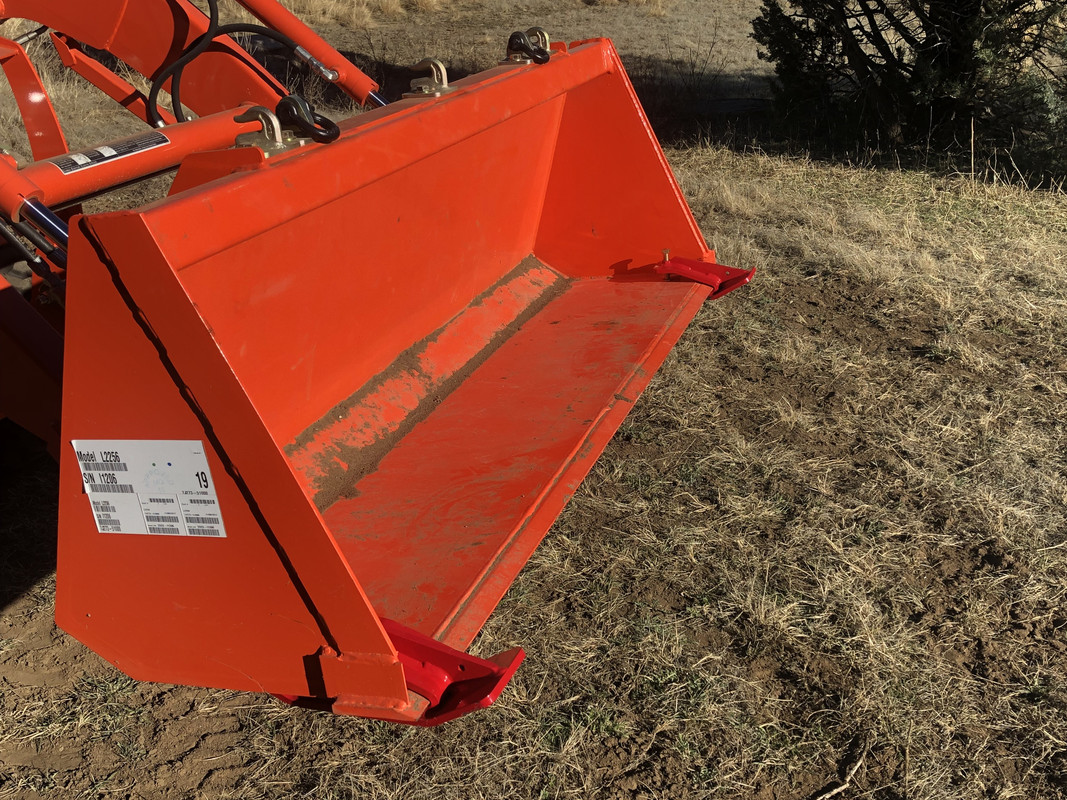

I finally got a set of Edge Tamers for my bucket and installed them today. Of course, now we have no snow in the forecast for the immediate future. Well, at least I am ready for it!

They are a great product!
If you have much crown in your driveway, a third one in the middle of your bucket is a good idea.

Those work great! I leave mine on most of the time now, unless I need to really dig into a pile of material. They work great for snow, and for cleaning manure piles up in the paddock in the spring. I have even pushed piles of leaves in the fall with them on the bucket.

That or perhaps moving them part way towards center might just do the trick.
I had a member on another forum recommend that I move them in about 10" from each side of the bucket. I think that might be a wise idea.....

All depends on crown, road width, plowing width etc. I’m sure, when it snows for you in about 3 years, you will get it fine tuned to your road.
As an example I have a 6’ bucket and a 10’ road with crown. I’d probably start with one on the right edge and the the left one in about 18” or so. Then just run down the “right” side of the road.
