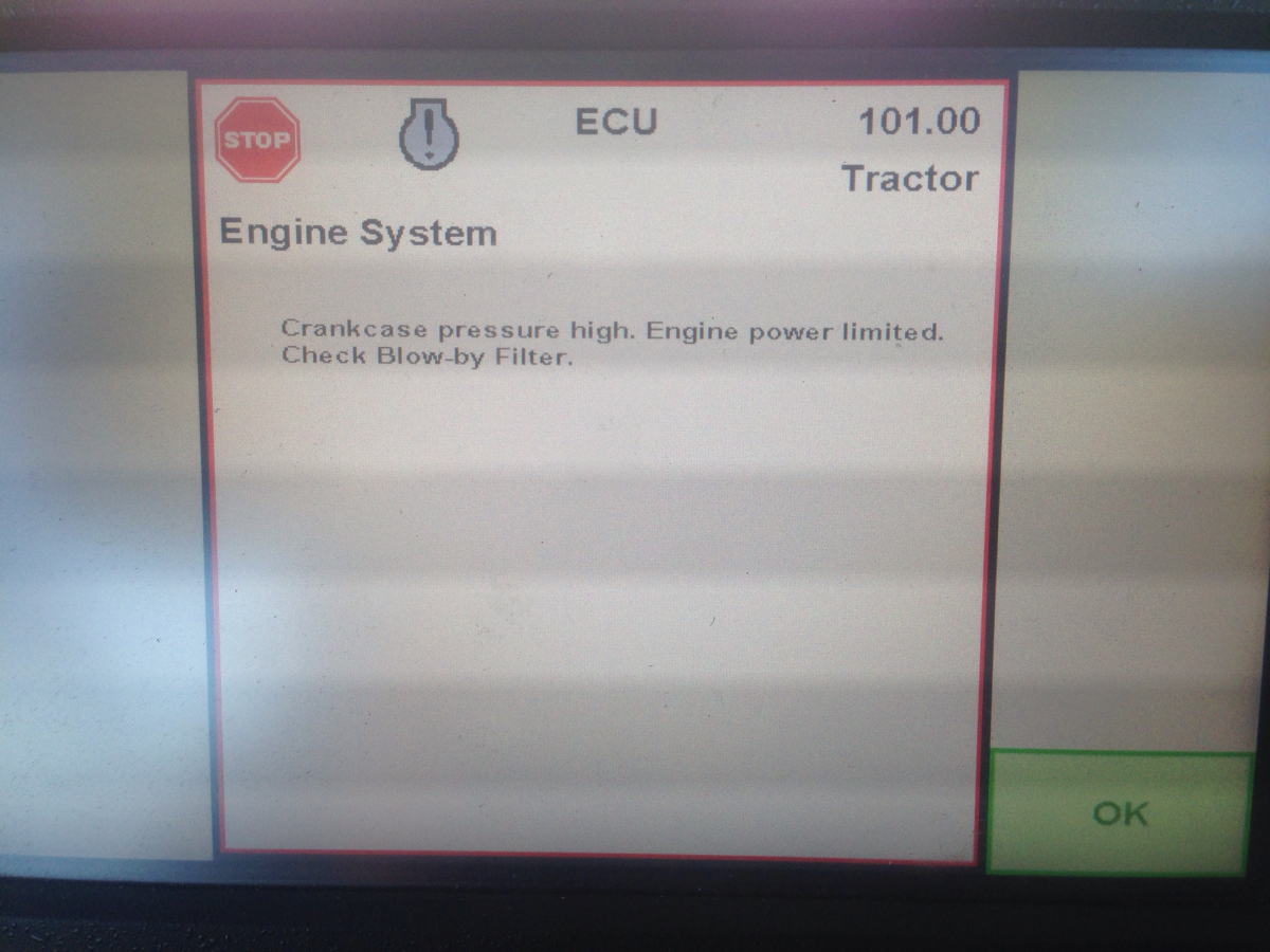

Hello, I started my tractor up today and was letting it warm up when I got this error code on the display:
ECU 101.00
Engine System
Crankcase pressure high. Engine power limited. Check blow-by filter.
When I got this code my rpm's dropped and the tractor started idling really rough. Thinking that it's cause components are cold I let it idle to warm up and then shut it off and started it back up and got the same code. Both codes happened within 5 mins of idling. Anyone have any ideas or suggestions as to what's happening and what I can do to remedy it? Thank you.

It sounds like you need to replace your open ventilation crankcase filter (OCV) - part number RE540710.
What caused the filter to clog...unknown.

The mechanic came and the filter was clogged with water and oil, he said it looks like a design flaw from John Deere and put in a request for them to review it. The line going into the filter is facing away from the engine so it takes a very long time to heat up and if there is any water in it the water freezes plugging up the line. I had to cover my radiator 3/4 with cardboard as well cause my engine never gets to full operating temperature of 80*C so the thermostat never opens up.
I'm starting to not like all these emission reducing items, especially if they fail and the whole tractor becomes inoperable cause they say so not cause there is an actual problem with the engine. The good thing is the mechanic told me how to bypass the filter should it happen again. It's a temporary fix and is messy but at least you can still use the tractor. Just pull the line on the top of the canister and let it hang out and then there will be no pressure build up but it will spurt oil and water out that the filter would catch.

Just curious, how many hours are on your tractor? I wonder if you have a bad thermostat since the temperature never comes up.

It's got 138 hours on it, it's barely broken in.
If technician knew how to bypass the filter it would appear to me that he's encountered this problem before.
Yes, apparently it's a known issue with John Deere and right now all they say is replace the filter, the mechanic will give them advice on how to make it better so it won't freeze up. He said the idea is good, just poorly designed.

I wouldn't recommend removing the element. It might cause the water vapor in the blow-by to condense and drain back into the crankcase. Better temp fix would be to disconnect the filter inlet hose from valve cover. Extend hose to below engine to prevent any mess on side of engine.
