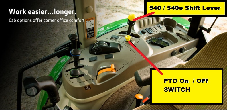

If your tractor is equipped with the 540E PTO, you need to shift the PTO into that mode by moving the yellow lever on the right hand console forward from the PTO to the ePTO setting.
If your tractor does NOT have the ePTO feature, your dashboard will still show that mark on the tachometer due to the fact that all 5M`s use the same dashplate.
See the attached photo.
Hope this helps!

Checked this out a little further, the 2wd sync plus did not have e pto as an option and it appears that it can not be added to that particular tractor either. It was a feature on M's with 4wd only.
