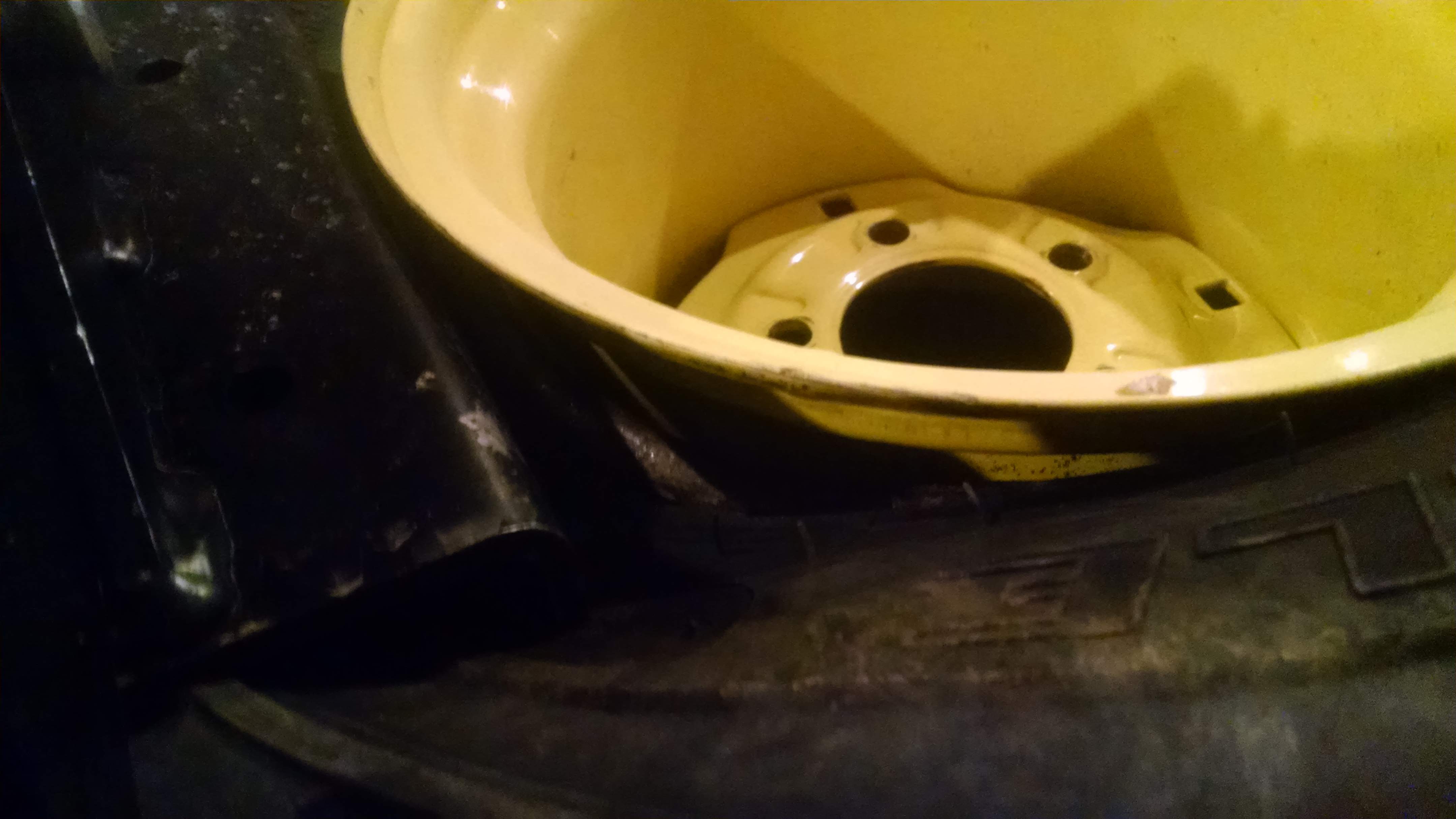

So I've wanted filled rears and after I got my backhoe I made up my mind I needed them. Thought about a tire valve but then it hit me to just use the stabilizers like a tire machine. IMG_20151121_162744966.jpg
Worked like a charm then I was able to pour in rv antifreeze. Got 11 gallons per tire in my 26-12-12 tires leaving enough room for some air.

Reminds me of using a bumper jack to break the bead back in the day.
