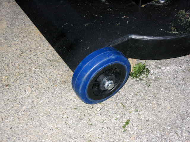

I think Charlie did this earlier but I thought I would post what I did to my mower deck to get it lower to the ground. There are some situations where I need to cut the grass VERY low ans the stock PT wheels are too large. I went to Harbor Freight and picked up some smaller caster wheels for around $12.00 each. They come with a sleeve and a greese zerk. They fit the PT bolt and when installed, allow me to lower the deck almost where it is touching the ground.
They are a hard rubber tire with a cast wheel. I picked up some 10" hard rubber replacement wheels while I was there for the front. $6.00 each and heavy duty!!
Notice that they are pretty blue too, ooooh... /forums/images/graemlins/ooo.gif

i added 1/2"thick steel plates between the front casters and the deck that lowers it 1/2" per plate. just add longer bolts,i had two more holes in the back to go,lower it back there. this works very well /forums/images/graemlins/cool.gif

the lowest mine would go was 3"i don't have pics of the mod to the deck but it's simple, a spacer between the caster mount and the deck.infact i tacked the 1/2"plate to the caster mount to drill it on the drill press. because the plate PT. used wasn't square. /forums/images/graemlins/smirk.gif

i found that the front needs to be lower than the back,so it doesn't leave piles of grass when it wet and high.by lowering the front i can use the spacers that pt. has to make tha height adj.down to two ins. up to four with the pull of a pin. on the back you still have to remove a bolt. /forums/images/graemlins/smile.gif
