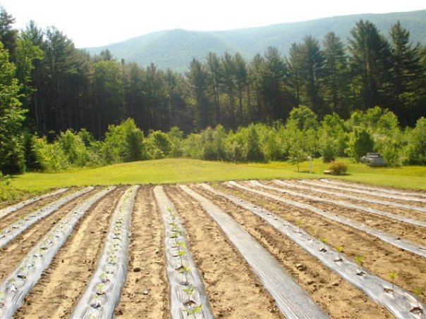

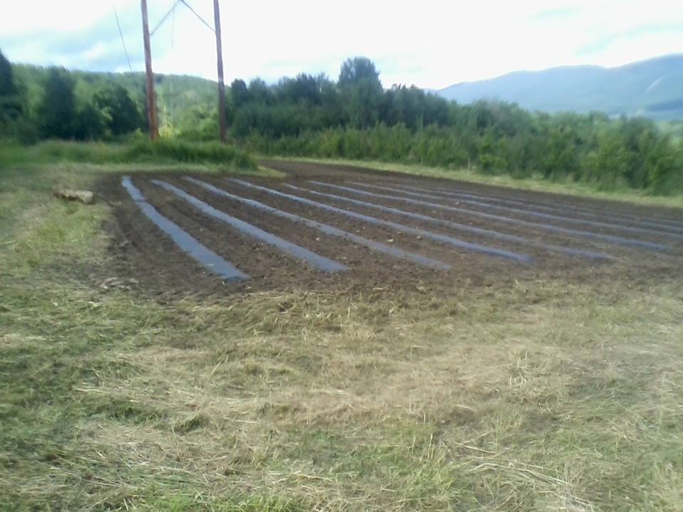

I often wondered just how well they do work on a 2 wheel tractor so I just watched this video. Seems the 4 ft model is just wide enough that its a reach keeping the tractor running straight. :D
Overall any of them should work just fine but it looks to me using the narrower models might be easier to control the tiller with.
I have the 2 foot model for almost 15 years now but I run it on the 3 pt hitch behind my tractor. Lays down a nice mulch bed right between my wheels. Done a lot of commercial growing using it.
Last time I looked the 2 ft wide unit wasn't listed on the website though it was there last season. Just see just the 3 and 4 footers right now. I have been getting my 2 ft wide plastic rolls from Earth works for a while now 2 ft wide works great for single row crops
The tool itself beds down plastic just fine. There is a small learning curve getting the openers wheels etc, rear paddles set right. And soil tilth and moisture content is key for best results. If you tuck it down tight enough you can almost mimic having a raised bed the plastic will be slightly higher than between the rows. Just remember higher the formed bed the more plastic needed to cover over the sides.
Pricewise I have always felt them to be a very competitive option for small tractor owners and small farming not as rugged as larger and more expensive units but still very decent.

I have seen that Terrateck being promoted some other places online. I'm sure it serves a purpose...specifically working in tunnel houses and other places where there might be issues surrounding using fuel powered machinery. And have no doubt it is a good tool but I'm also figuring optimum conditions like well worked soil, stone free etc. are really best needed to successfully use it too. But maybe I'm just spoiled being used to moving right along running a 100 ft or more of plastic in just minutes. :D
I have laid down tens of thousands of feet of plastic using that little mulch layer that I bought direct from Holland Transplanter many years ago and I like there are now updated variations of it that EarthWay is selling.
Just to note in that first photo I added if you look closely there is a break in the plastic first row to the left and that large object is huge rock that was in tha field garden (unbeknown to me :confused2:) and when I caught it under power it twisted the mulch layer up pretty good but the frame it is flexible enough and strong to straighten back with bar etc. so still as good as new. I have bent the openers numerous times too in field situations.
So I guess it all depends what a person wants and how they want to achieve it. :thumbsup:
