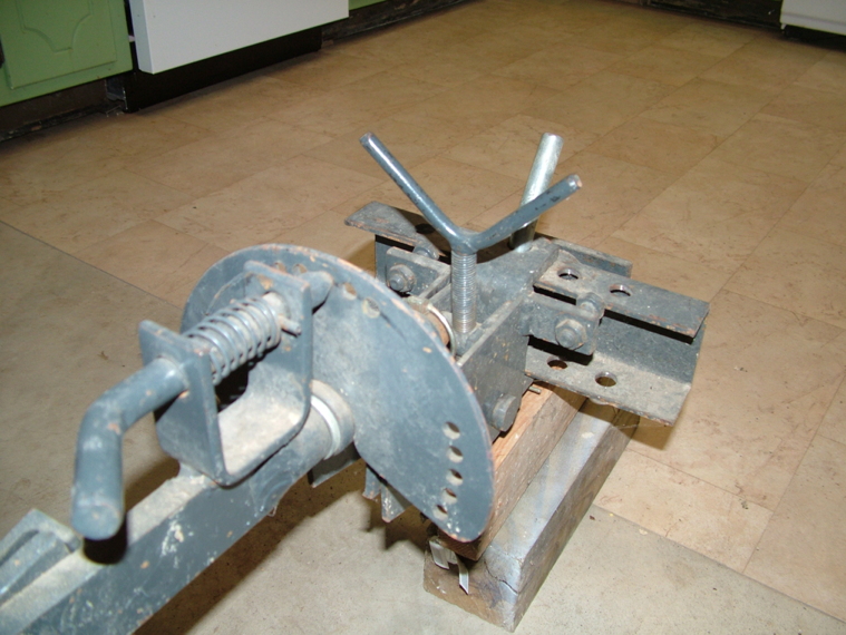

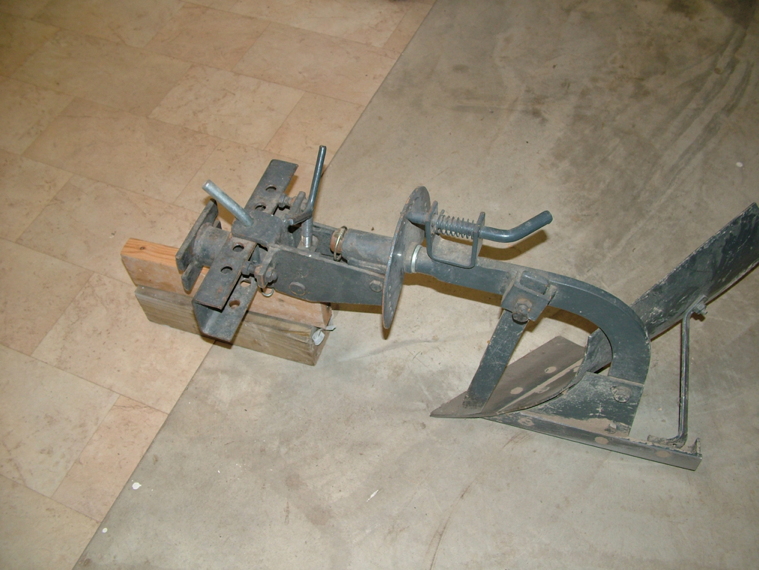

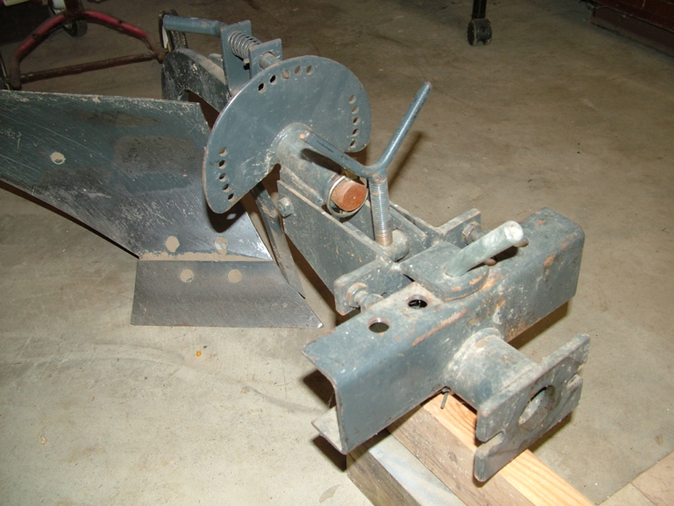

Did Chris know you're going to be doing this with a 720? You're going to need a lot of weight and bigger tires to pull the double ridger. It can be done. I dug potatoes with a 730 with 100 lbs of weight on each side, 6-12-23 tires, and free-wheel devices. I'm not sure the idea of hilling potatoes is going to work unless you turn the disks to throw out and drive between the rows. With the clearance under the engine and transmission, you wouldn't be able to hill them past about 4 inches without damaging the plants. if you have enough weight and tires, you could buy 2 more disks and hill two rows at a time, though...
Your tool carrier *should* be fine for the ridger. Post pics to be sure.
   / Earth Tools Double Ridger question
fbb,
Chris never inquired about the model. In fact the potato hilling was merely a secondary benefit (BTW, I have 6 to 7 inches clearance under my tractor). The main use was to use the device to clean out my paths and push some of the soil back up onto the beds. For the amount it costs I'm probably just going to use my moldboard plow and do one side at a time, though if I can pull the plow through unplowed ground the double ridger through worked, soft ground would be a breeze. I will post the tool carrier pics later.
