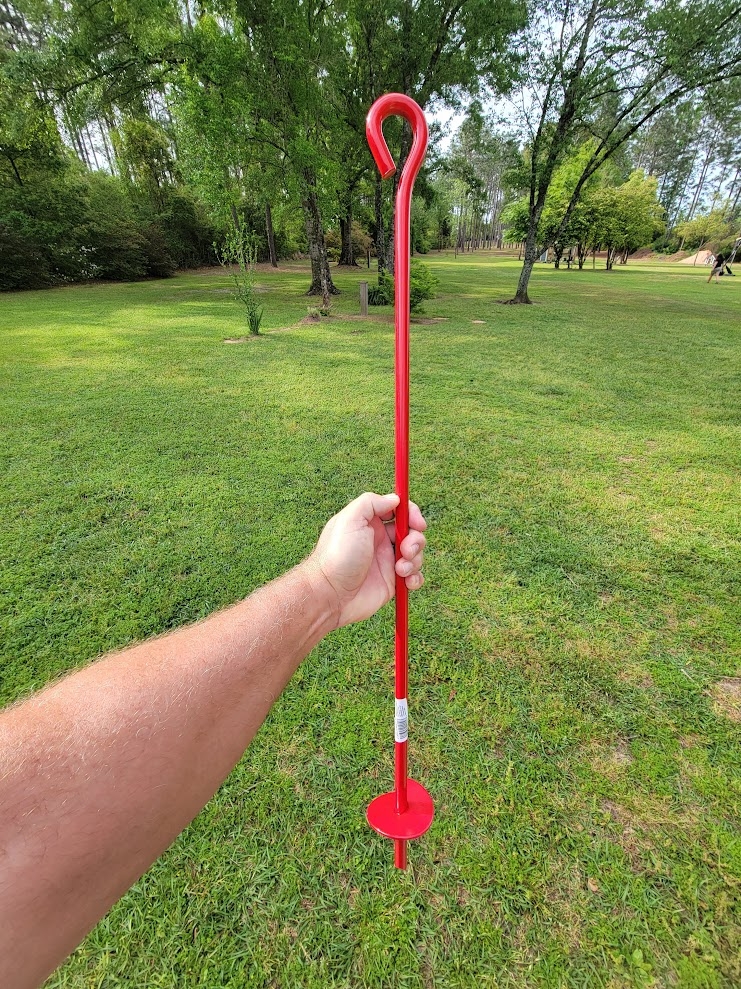

This is unscientific, I'm not a physicist or engineer and didn't stay at a Holiday Inn Express last night.
I do however live in a hurricane area, and I use a lot of earth anchors to hold things down, sheds, greenhouses, trailer tie downs, etc.
I've seen things on the internet showing how easy they pull out and you should use this {insert more expensive thing here} instead.
Most tests I see, the anchor is installed and then pulled right out showing a few hundred pounds of holding force.
So I had a plan. I would install a single 32" single helix anchor with the 3" plate and measure the axial pull out force. I use a fair number in this size, and I also use longer 4" versions for larger things. The 3" plate is 3 inches up from the bottom, and the eye is 3 inches above ground level, so the holding plate was approx 26 inches in the ground, my ground soil, not yours, no clue how it will hold on your land lol
Then I'd install the same anchor and let it sit for 2+ months to let the disturbed ground harden up again and repeat the test to see if it improved.

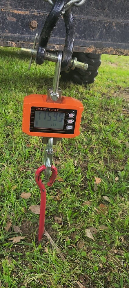

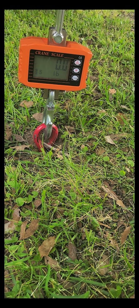

This ended at step 1! I figured I'd see a couple hundred pounds, maybe 400lbs , 500-600 if I was lucky.

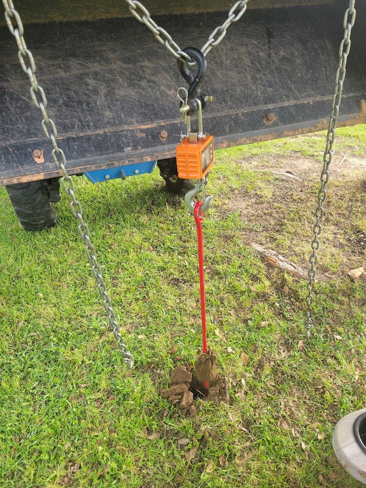

Well we saw 1800+lbs a few times, and the tractor was maxed out (even though the pic is ~1760)
I had to manually unscrew the anchor a few more inches before it finally pulled up and left a decent mound where it pulled the surrounding ground with it.
Very (happily) surprised!

I suspect like you that it varies a lot with soil type. How screwed in, I.e. Is down force applied while screwing it in or is it allowed to act line post hole auger and pull soil up. Also how long ground is left undisturbed before pulling, etc.

I use an impact wrench with a big socket to cheat when I drive them in, so a fair bit of my body weight when driving them in.
