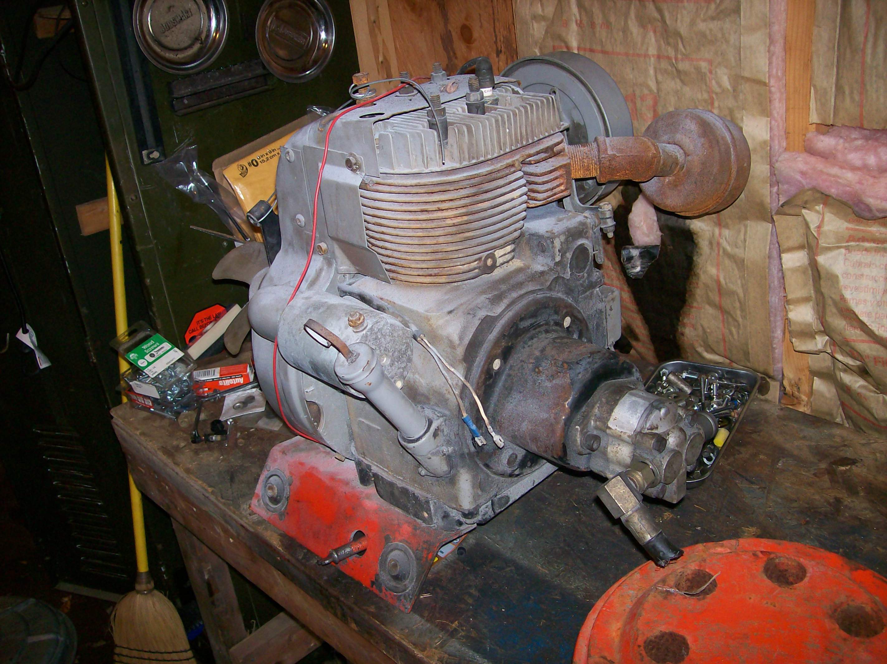

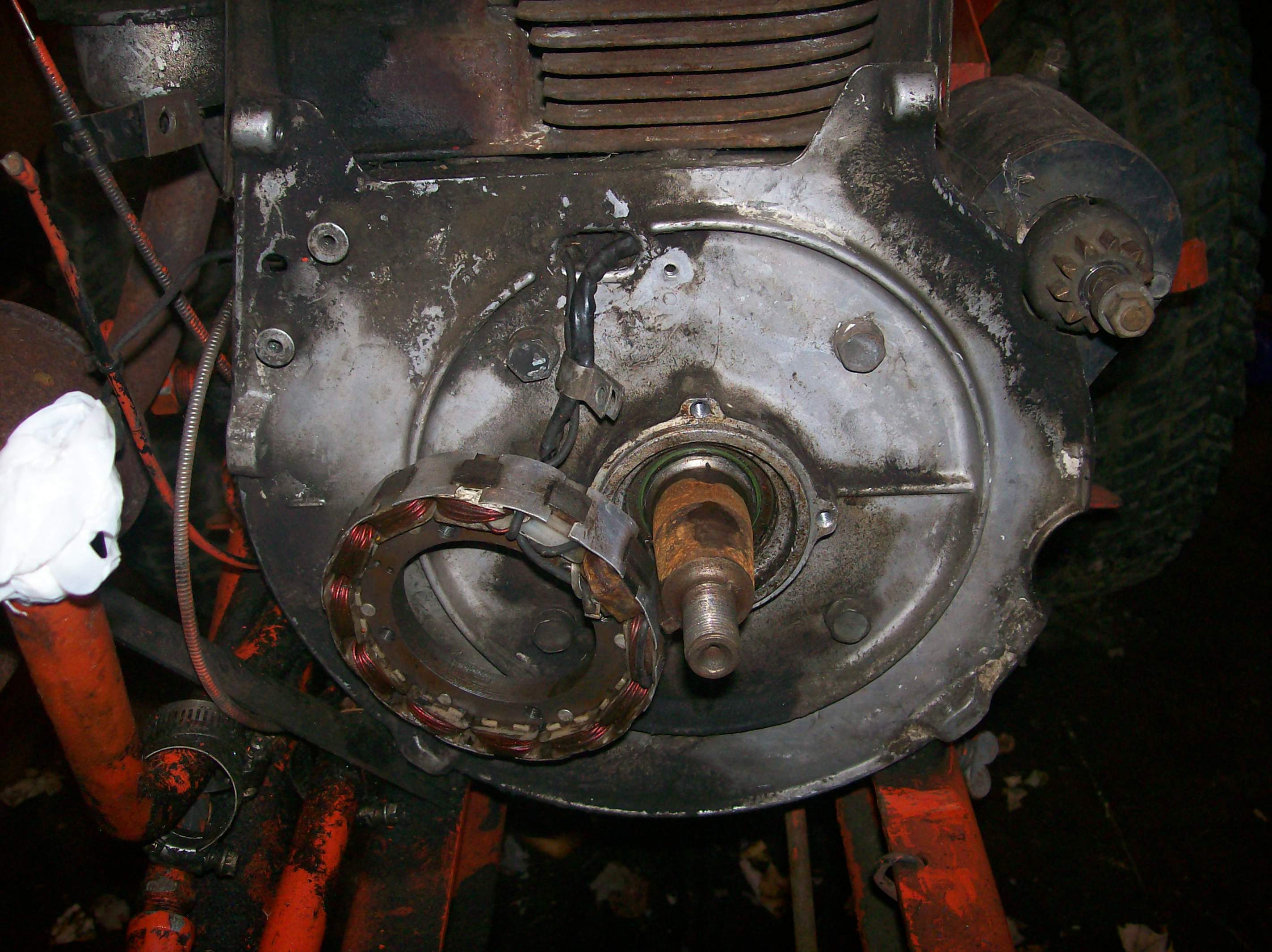

I am somewhat confused by the two photos you posted.
The first photo depicts an engine from a 69 or 70 Case 444. Obviously, the flywheel has been removed for some time, judging by the rust on the crankshaft. The 2nd photo shows a Kohler K engine from a much later Case GT, 1978 or beyond.

Hydriv - Sorry for the mixup. For some reason the written portion of the message was deleted. 1st photo is the motor on the 444. The second is the engine that is going to replace it. I picked it up early this summer with PTO and hydraulic pump included. The original (1st pic) is going out for a rebuild once the swap is completed. That info should have been included earlier. I was hoping to solve the charging problem before the engine was rebuilt. There are some excellent sites on the internet for elec trouble:

The flywheel on the 1st photo was removed earlier this summer. I assume the flywheel should be reattached to run the tests you recommend?
