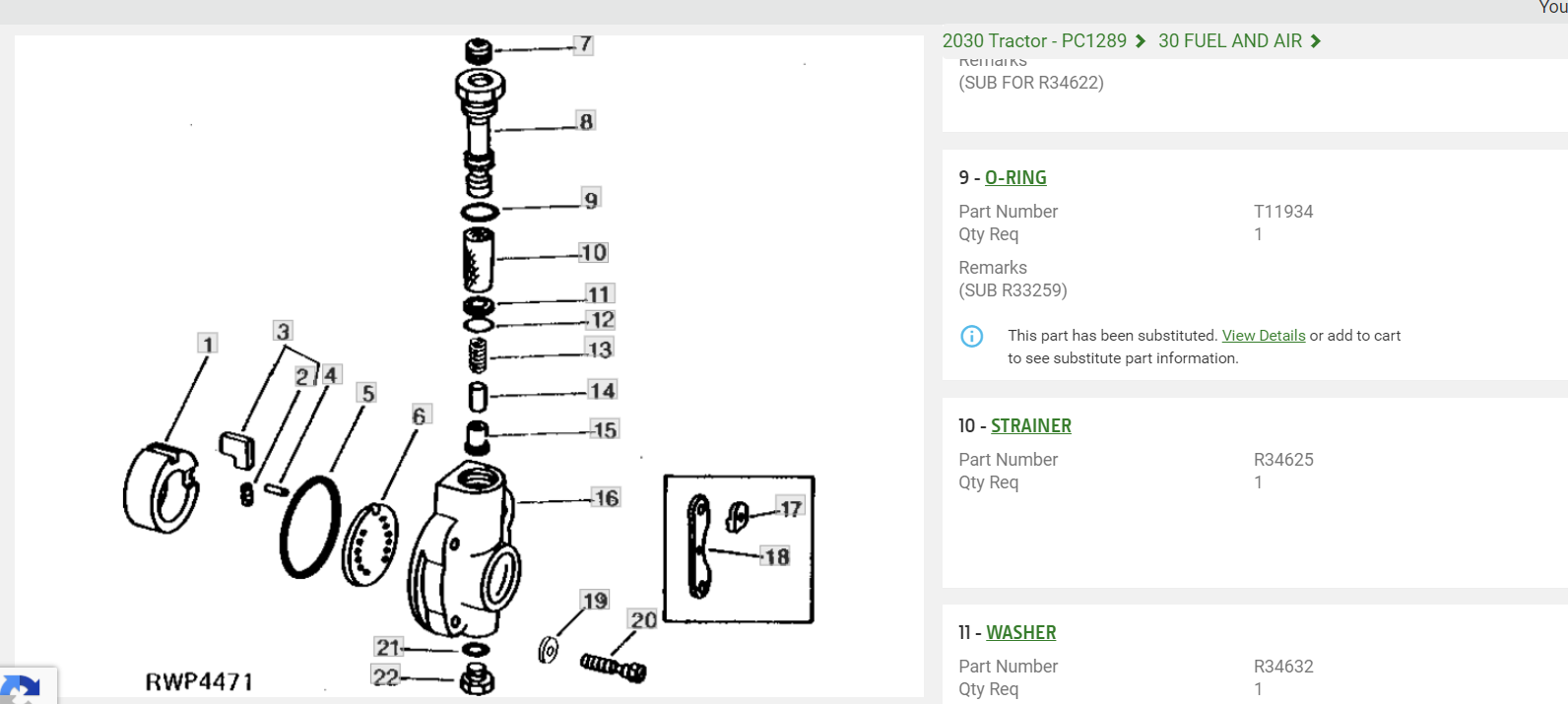

Hello all;
I have a 1970s JD 2030 diesel use on a 10AC Pecan Orchard (Just south of San Antonio, TX). It has been starting without problems once weekly but the other day we had weather low about 35 for a couple of hours and now it will not start; cranks but no start. Fuel tank was full had treated with stabill. And since poured Octane 911 according to instructions, still will not start. Not sure what else to do before calling in a mechanic.
Any ideas that could help, Thanks

My 1st guess is check valve is clogged that fuel return line attaches on inj pump BUT does your tractors ign switch control fuel to injectors. If so does wire at IP have 12 volts when ign switch is turned to "run position". If there's 12 volts when switch is set at run position is a "click" heard when activating key switch? Inj pump has a strainer in plate that fuel supply line attaches to on IP accessed by removing fitting that line fuel supply attaches to.

No smoke out the exhaust pipe, I checked the air filter was dirty blew it out with some compress air, checked the fuel filter it looks clean/clear. Oh I have the Roosa-master inj pump; Today I cranked it again still will not start - took a small video but don't know how to upload is in mp4 format.
   / Early 1970s JD 2030 Diesel will crank but not start #10
Has screen(key 10) been checked to be sure it's not clogged? Can you hear fuel control solenoid on IP make a click sound when ign switch is turned to ""on position""?
Try starting engine with the 2 timing window screws loose on IP allowing fuel to drip. Performing this task relieves a possible excessive internal IP pressure created by a clogged fuel return check valve or line
