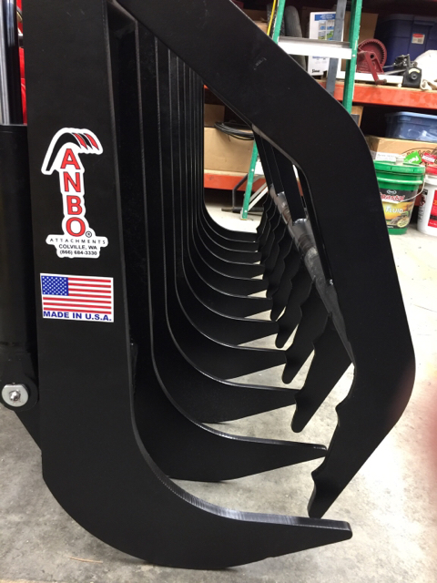

The Anbo would have suited you better. With the steel they use, I've yet to bend a single tine while I was maxing out on the capabilities and more. The tractor will break before the grapple gets a ding.
