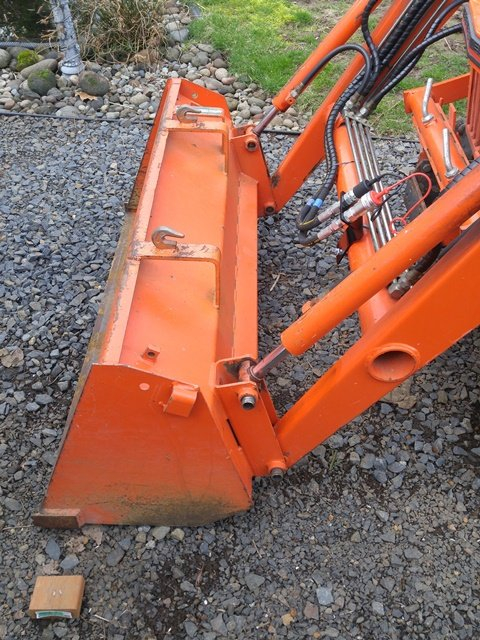

The B2150 is not a big tractor by any means. So adding a grapple to it meant it had to be as little weight possible, but I wanted one with durability too. Adding a Quick attach system with the additional 100-125 pounds out front was not something I wanted to do. EA's EA 55 Inch Wicked Root Rake Grapple seemed to match my needs with a pin-on option.
Tons of research later on my FEL & Bucket, comparing them to other FELs & buckets. It looked like the LA402 pin configuration was very close if not the same as mine.
With the help of Travis taking measurements, Emails, and phone calls, I determined that the LA402 pin-on was the way to go. So, I ordered an EA 55 Inch Wicked Root Rake Grapple with the LA402 pin-on. It arrived 8 weeks early! LOL just kidding.

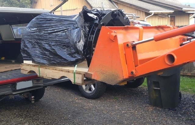

Unloading it with the tractor and clamp-on bucket forks.
There she be in all her Wickedness!
Removing the bucket and trying the grapple on for the first time.
Whoot! The LA402 pin-on was an exact match!
I did have to adjust the quick coupler mounting bracket on the loader cross beam for the hoses to work better. I moved it to the right side a bit. Also readjusted the forward hoses from the 3rd function valve. All have good clearances and protection. I also replaced the cotter pins that keep the loader pins in with some round head wire locking pins for faster removal.

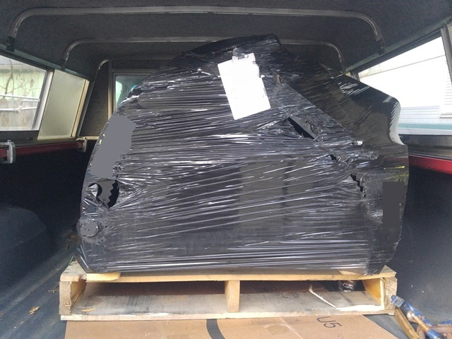

Thanks for posting the photos! Looks great I hope to hear more about it. I ordered one last week it should be in by the end of the month lol. The photo of it being in your truck with bed cap on it was useful knowing mine will be able to do the same. I thought I may have to borrow a capless truck. I hate taking that cap off or worst yet back on especially if I don’t have to.
   / EA 55 Inch Wicked Root Rake Grapple For Kubota B2150
Ya, a pin-on is the odd ball in the park for sure.
Travis at EA was kind enough to get detailed measurements for me on packing size. My nearest depot for pick up is an hour away, so I needed to know if it would fit with the cap on. It had plenty of clearance all the way around.
My cap is all aluminum so it's light, but still not easy to remove by myself.
Here is a shot of it in the truck. Long wide bed. Can't slide anything on the bed liner, that's why the box is there. Gives it just a bit of slip, but it won't shift around while driving.
