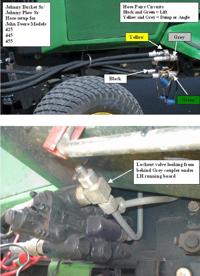

I am looking for a colored dust cap diagram for a John Deere 425 tractor. I have the dust caps, I just need to know how to place them!

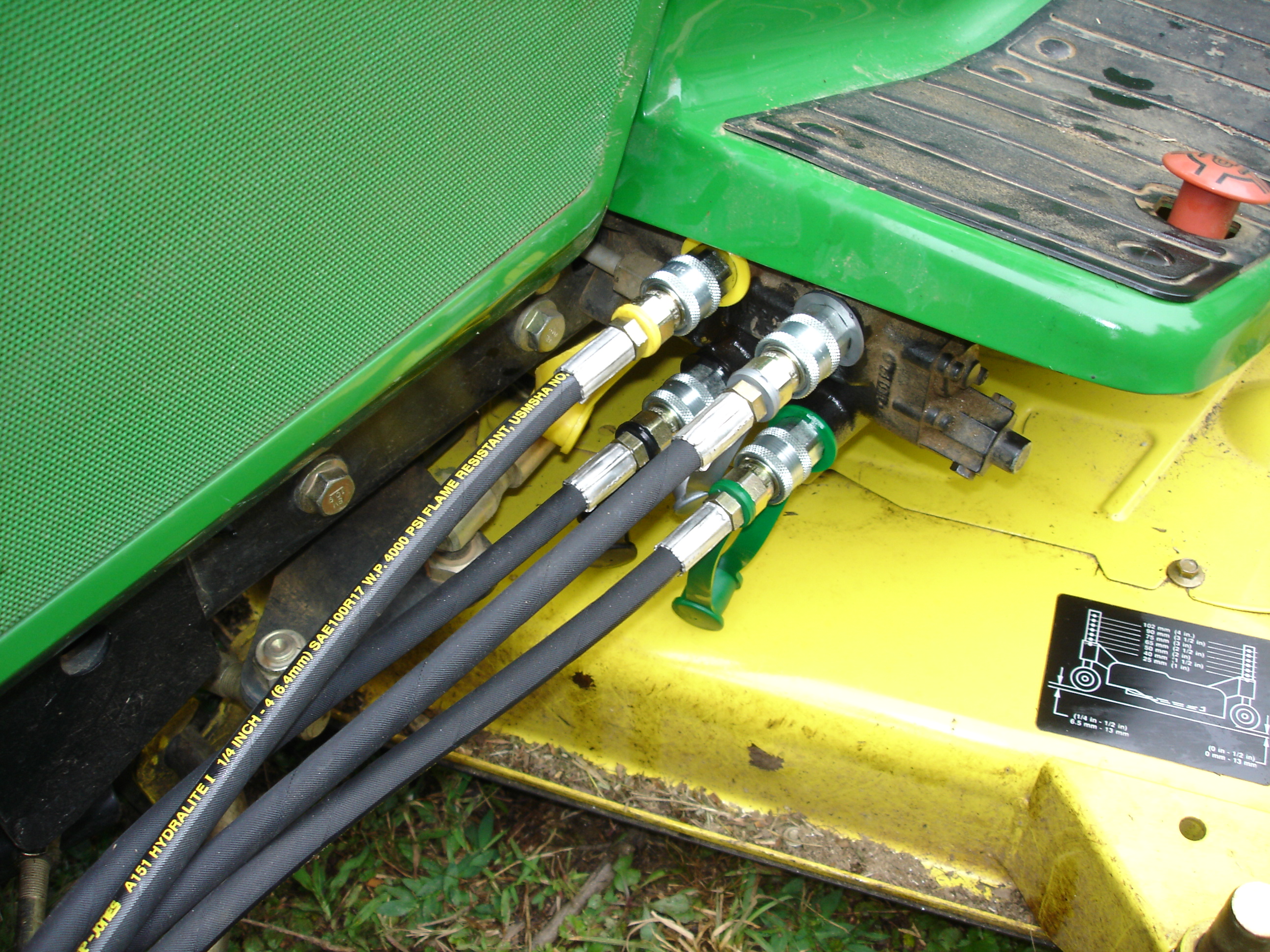

I have an x485, it might be the same?
Top row: Black, Green
Bottom row: Yellow, Silver

Thanks, I'd like a diagram so I know for sure. I'd sure hate to get them mixed up!

Does your's have the same colors? JD AG tractors do not use Silver or Green on the four loader connections. They use Red Blue Black Yellow, plus Green and Orange if the valve has a third function.

Mine uses the same colors as yours.

Thanks for the reply. If you do not get an answer, I know a guy with a 455, I could check his, not a 425, but same era tractor.

Does it really matter how the factory ... any factory does it? All that matters is that you match the connectors, so YOU know how to reconnect them. Red > Red, Blue > Blue, Green > Green, Yellow > Yellow. Doesn't really matter what function Red goes to, does it?

No, it really doesn't. It's just that if you pick up another implement at a later date, it can save some headaches.
How do you know if the hoses on the other implements are correctly color coded ??
