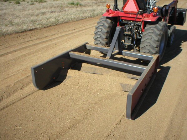

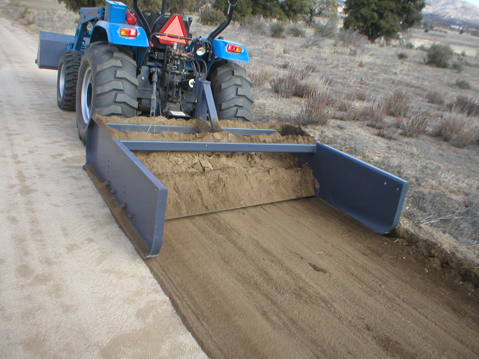

I have 2 of these blades myself. I use a 60" medium duty blade behind my Mahindra 3215HST (32hp), and an 84" heavy duty blade behind my Mahindra 7520 (75hp). There are several things to consider when purchasing any ground working implement.
A:weight of tractor
B:horse power of tractor
C:type of ground that you will be working
Unless you have a biiiiiiiiig tractor,:laughing: I would stay with my recommendations for width to be used. ;)
