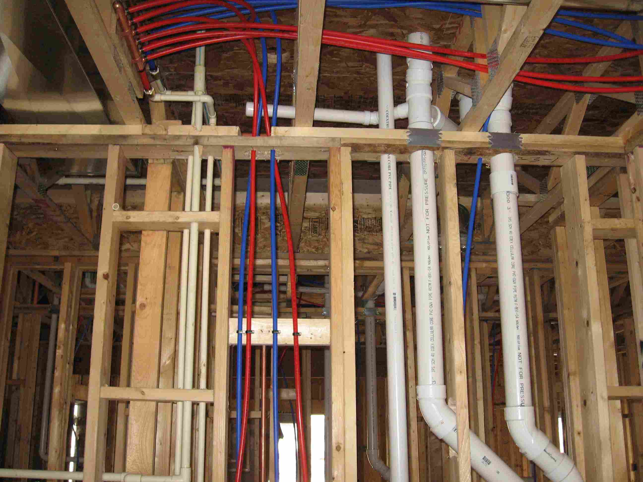

I'm in the middle of a condminiums project right now and we just installed a bunch of Pex. The units were fed through PVC lines to a copper header and then each fixture was given a "homerun" line from the header. Let me know if you would like to see more pictures.

I think that picture you posted says it all. If it is durable, that is one slick routing scheme from the copper header manifold. That makes plumbing almost as easy as running electrical wire. Can plumbing junction boxes be far behind?:)
