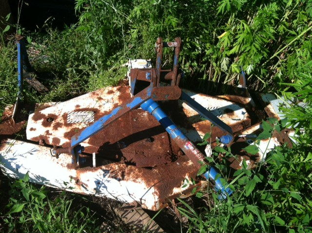

Has anyone heard of DURA 3pt finish mower? Model number would seem to be M-54-RMO1 mower. I am thinking about buying one but can not find anything online on them and I want to make sure I can at least get replacement spindles for it incase I bend one.
   / Dura mower and parts #2
I have a dura mower,model m-54-rm,has worked good,but I cant find parts on line either. stuff like belts and pulleys can be found locally,blades can be matched up also. I could use new bolts for the blades(7/16,fine thread,left hand thread)-I cant find these.
I would be careful as those bolts might be metric. I looked at the manual I have and the Part Number/title is 20028052/L.H. Bolt. If it is the 7/16 then you could buy some threaded rod and weld a nut on the end to make a bolt. Not the best but keeps it mowing. If you are able to confirm with a thread gauge and micromiters please repost the pitch and measured max diameter. I have not taken my blades off yet so be interesting to see if they are the same. Another option you might want to justdrill and retap the spindles.
