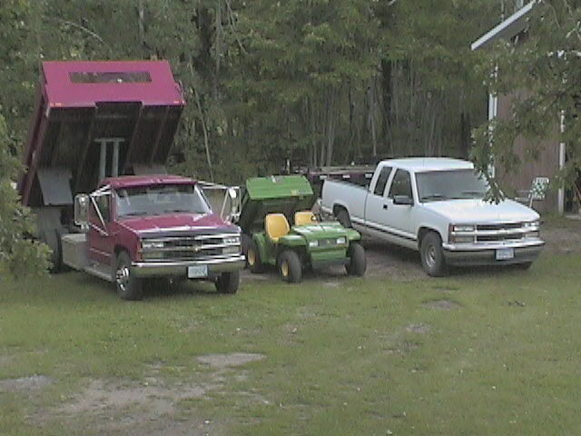

My search ended at a local auction with a '93 6.5 turbodiesel 5 sp 48K mi. A retired business owner bought it to pull old cars home & restore them.
Newer ones have more power but there are constraints. First is a trailer over 10K lbs requires the driver to carry a DOT medical in MN. Over 26K combined weight rating puts you into CDL A drivers license territory.
Mine is 12K truck and 13.5K trailer rating. I generally drive it around the engine torque peak which is 1800 rpm and 52 MPH in overdrive. It'll go 70+ but controlled stopping is what matters. The truck weighs 9K empty in front of a 12K trailer and never felt unstable. Engine power is a factor on hills but keep it in perspective - all that traffic is behind you /forums/images/graemlins/confused.gif
Pushing a button to dump a load sure beats shoveling it out of a pickup /forums/images/graemlins/grin.gif
A new F150 has a 9900 trailer rating... must be bureaucratic magic /forums/images/graemlins/grin.gif
Keep us posted on what you buy

Here's an example of one I'm a bit scared of for too little truck with a 7000lb trailer..
Cute litte green dump truck
   / dump truck #9
They can't see or breathe well enough behind me on a long uphill pull to get mad because that old underpowered chebby is smoking like an old freight train /forums/images/graemlins/tongue.gif /forums/images/graemlins/tongue.gif /forums/images/graemlins/tongue.gif
That short wheelbase would be more nimble around the farm. Simplicity of something that old is a +. Parts are easy to find @ LMC truck & others. You can find specific advice on Ford & dieselpage.com forums. I signed on the Chevy one for a year or 2 when I first bought the dump to learn the nuances.
Weight and duallys help avoid being pushed around. That truck is probably enough for a 7K trailer. Question is how much more do you want?
