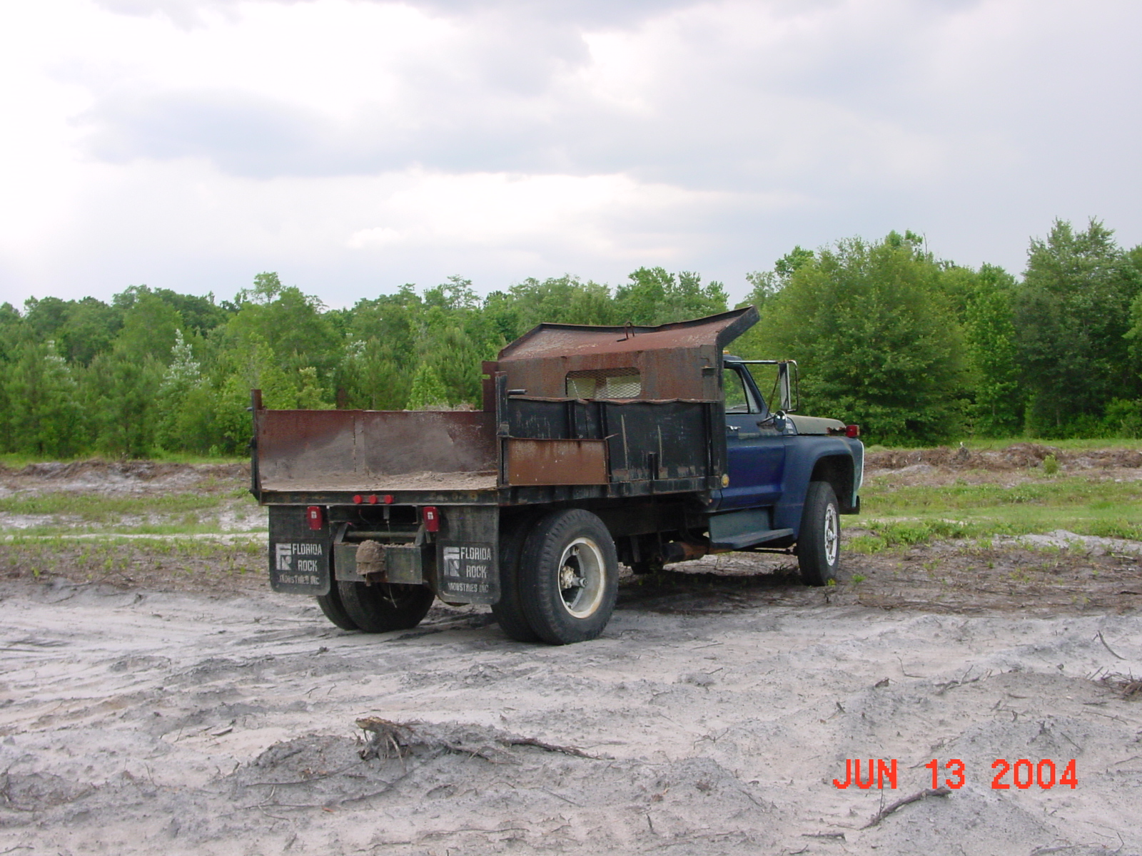

   / DUMP TRUCK #7
I've got a Ford 1979 F700 dump truck. The clutch pedal must be to the floor to engage the PTO for the pump. Let out the clutch. Then pull the Knob connected to the cable that diverts the oil flow at the pump to raise the bed.
The pump is a gear pump and is virtually indestructible. To drop the bed, I push in the knob, which lets the oil from the lift cylinders flow back into the reservoir. The reservoir is located between the frame rails immediately behind the cab. The only way to check the oil reservoir or to fill it is to have the bed in a raised position.
You may have to hook a chain to the front top of the bed and to a tree. Then ease the truck forward (while the knob is pulled out so as to not create any resistance) to raise the bed so that the safety bar can be locked in place. This should allow you access to the pump reservoir along with easier access to the pump.
I found out that with short dumping cycle times; i.e. every 12 minutes, I had to go to heavier weight oil here in North Florida during the summer. I drained out the 70 or 80 wt oil and went with 140 wt. I've used it this way every since. I wouldn't recommend using 140 wt if you were in cold climates or planned to use your truck in the winter, but for hot summer temps and short cycle times, it solved my problem of the oil heating up and thinning, which required reving the truck engine to get sufficient flow rate to raise the bed.
