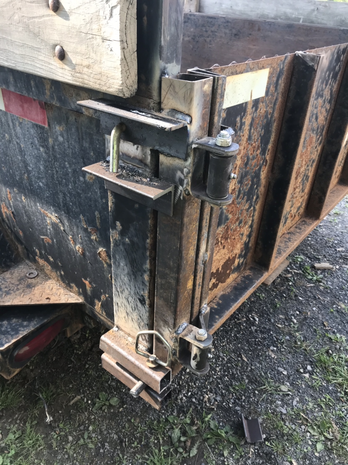

I sold my tilt trailer and my little 5x8 dump trailer and bought a 10k twin axle 6x12 dump trailer this week.
Trouble is that it came with a Landscape type gate ramp that opens two ways. Spreader and ramp.
I like the gate but think it might be problematic.
Before I change things, I wanted to ask the brain trust what your thoughts are.
1. The landscape gate is nice to roll stuff into on a dolly. =PLUS
2. Landscape gate is heavy to close and I’m not getting younger. =MINUS
3. I can see stuff like brush/trash getting caught trying to go under gate when dumped. =MINUS
4. Taking the gate off alone to dump would be a major PITA. =MINUS
So some of my beer enriched ideas are
1. Lose the gate, make a regular tailgate and carry loading ramps.
2. Add hydraulic assist to the gate that would raise it from the ramp position using a selector valve.
3. Make the gate a side opening (3 way)
4. Add a winch on receiver mount that would pull ramp up and help load stuff. This coincides with wanting to add a log arch to the back to load logs in the field to bring home. I’m liking this idea as it could be used to open gate wider with the winch cable connected to the top.
5. Dumping like a normal “drop the tailgate” maneuver won’t ever be possible with that big gate laying on the ground the load will all pile up on the gate. = MINUS
Firewood, trash, brush, dirt and gravel will be the main things dumped out of it while I have it.
It will be used as a utility trailer hauling treasures home and hauling not so treasures away.
Thoughts?
Thanks,
Lenny

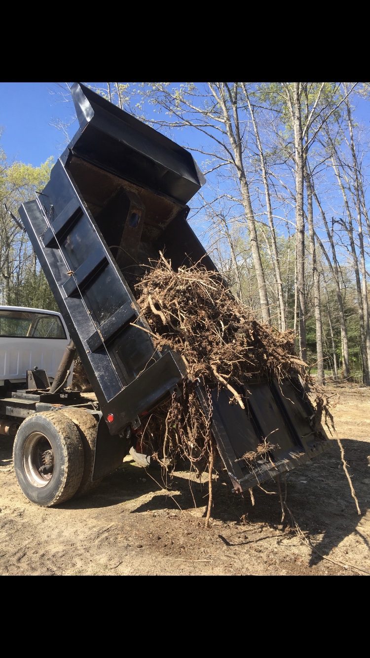

My little dump truck has a 2’ tailgate that I can hinge at the top or bottom. I almost always hinge at the bottom and chain flat which extends my bed to 10’ feet and the load slides off nicely. Another plus is it protects the lights on my truck and keeps gravel off which minimizes the amount I have to brush off. My big dump truck has a bigger tailgate like yours and it it has proved troublesome. I think having a second short tailgate to put flat for bulky materials and putting the tall one back on would be the best option. Making it a side hinge might be alright but opening and closing it might be problematic and you’d need a catch so it doesn’t get bent on the ground.

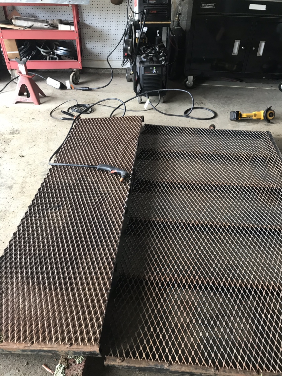

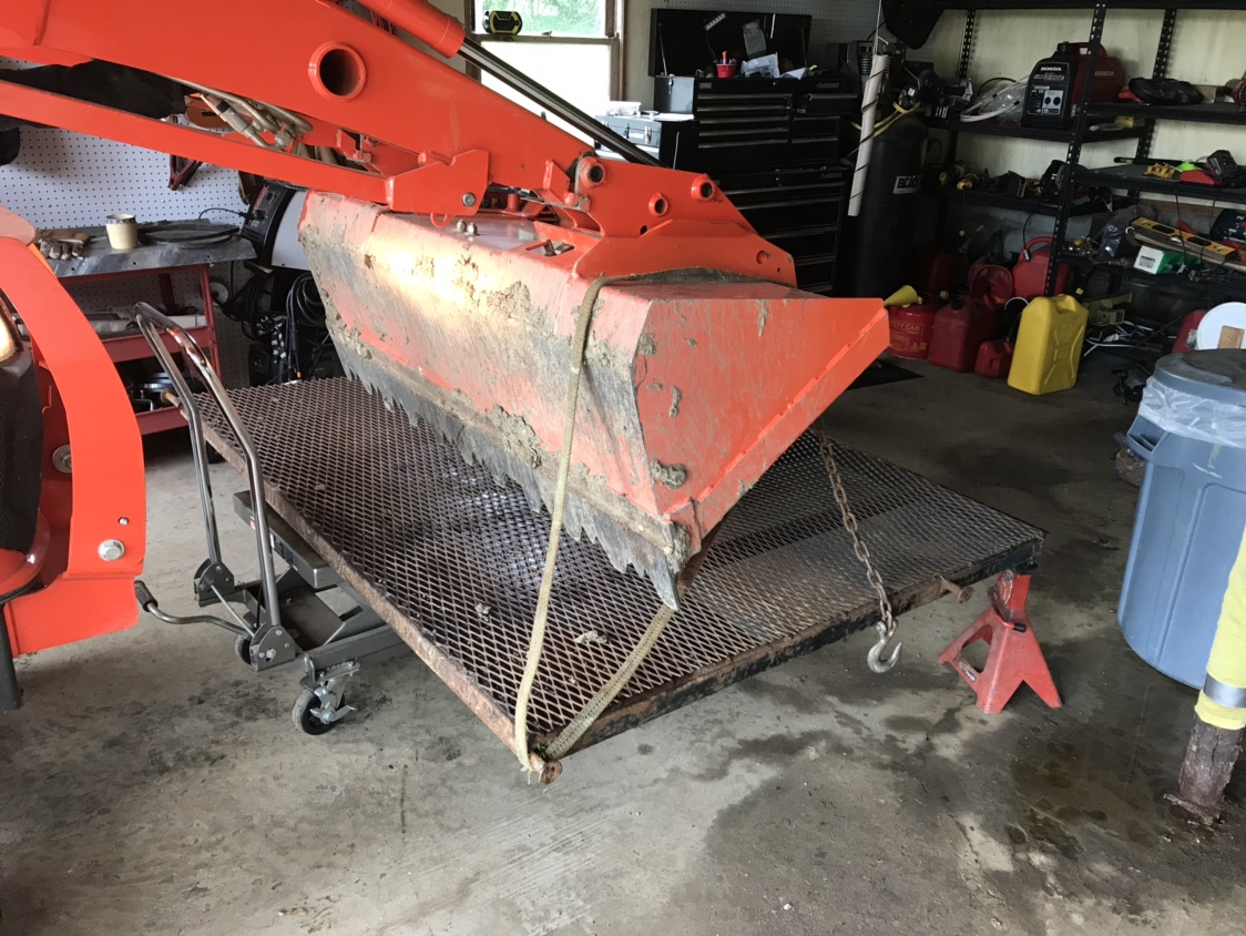

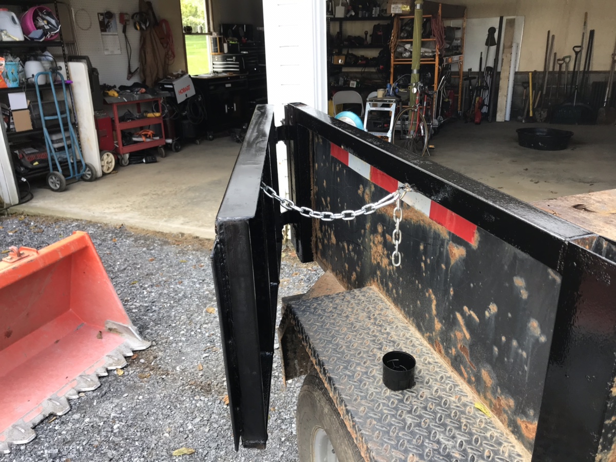

I had some time today and began converting mine.
So I used the tractor to bring it in the shop.
First thing was to cut the expanded metal loose.
Angle grinder with thin cutoff blade made short work here.
Then the slice down the middle.
Portable bandsaw and some finish up with the plasma cutter.
Still a work in progress after day one. I’ll get this first one done and then slice the gate into barn doors.IMG_0583.jpg
More details to follow after I make sure this is going to be a workable change.
Couple of notes.
That lower pivot pin receives a lot of pull on it when the gate is swung open past center trying to push its way toward the center of the trailer. Going to try welding a large washer on the end as a “stop” to hold against that force.
The weight of the gate pushes against the pin first half of the opening swing but then reverses as the gate swings past the half way mark.
Slots cut into the angle iron (one welded to trailer and other to gate) will work to hold tailgate drop chains in a fixed position horizontally with the bed floor.

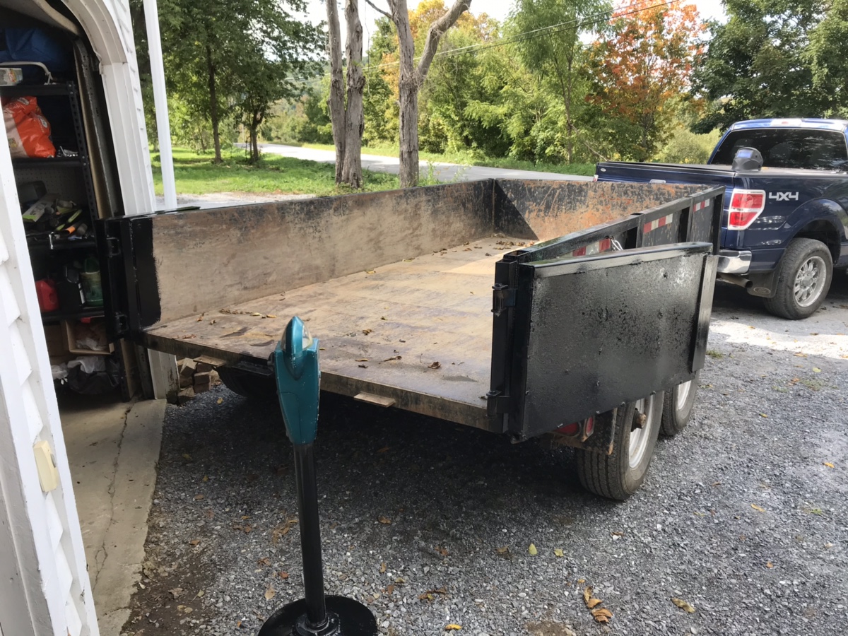

   / Dump Trailer with landscape gate thoughts

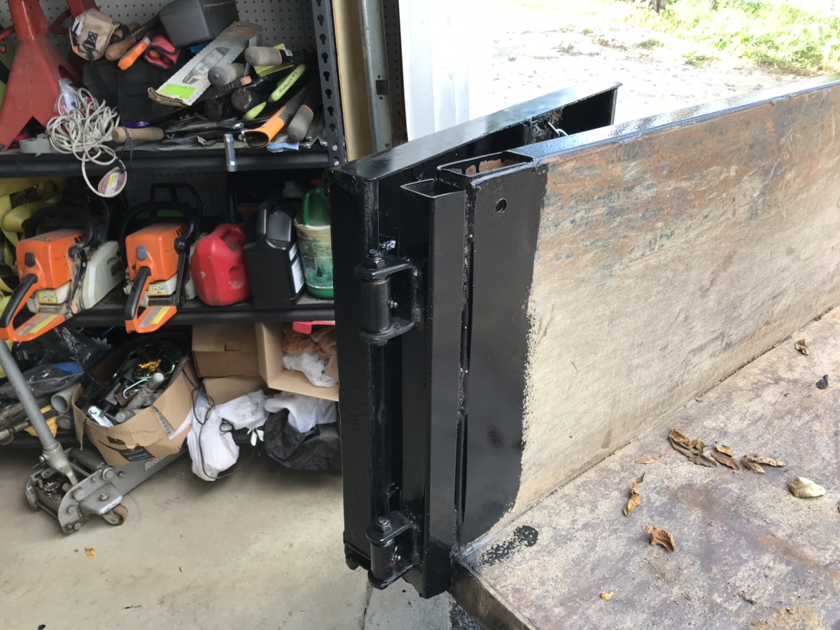

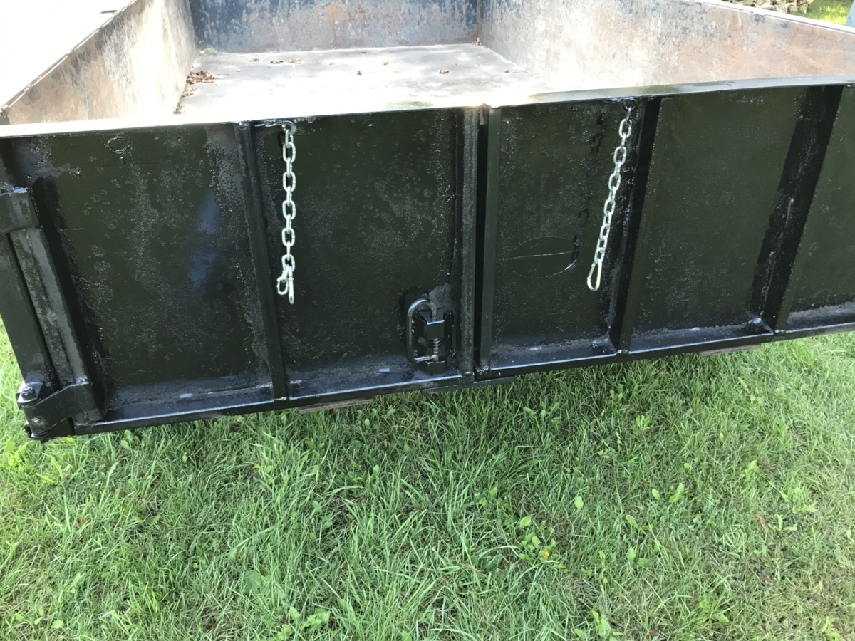

Try number one didn’t work well so back to the drawing board. I’m pretty pleased with this one now. IMG_1014.JPGIMG_1013.JPGIMG_1012.JPG
I’ll get a few more pics after the paint dries.
