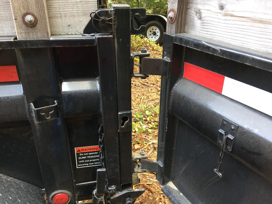

I don't know if this helps but here is a photo of the side hinge on my Load Trail dump. It also hinges on top and bottom.
   / Dump trailer Tailgate hinge ideas? #6
thats how my PJ Dump is done as well.. also some chain to limit the opening

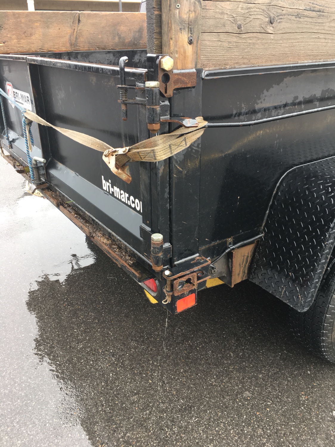

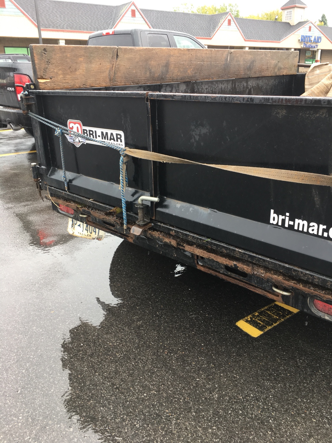

I ran across a Brimar trailer today with this set up.
I’ve been collecting up materials and about ready to start the changes.
