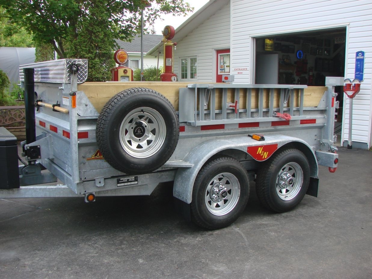

Lauren I bought a new N&N galvanized dump trailer this summer. It's got the telescopic three stage hydraulic cylinder that's power up, gravity down. Two 3500 lbs axels with brakes on all four wheels. Two way tailgate. It's lifted everything I put in it. Yes I've modded it. I installed the wireless remote for the dump. Mud flaps, fabricated aluminum ramps, spare tire mount, aluminum guard over the top cover, D hooks inside, chrome centers on wheels, mounted shovel and high mount led lights on the rear. I'm happy with mine. It's built like a battleship and built in Quebec.
