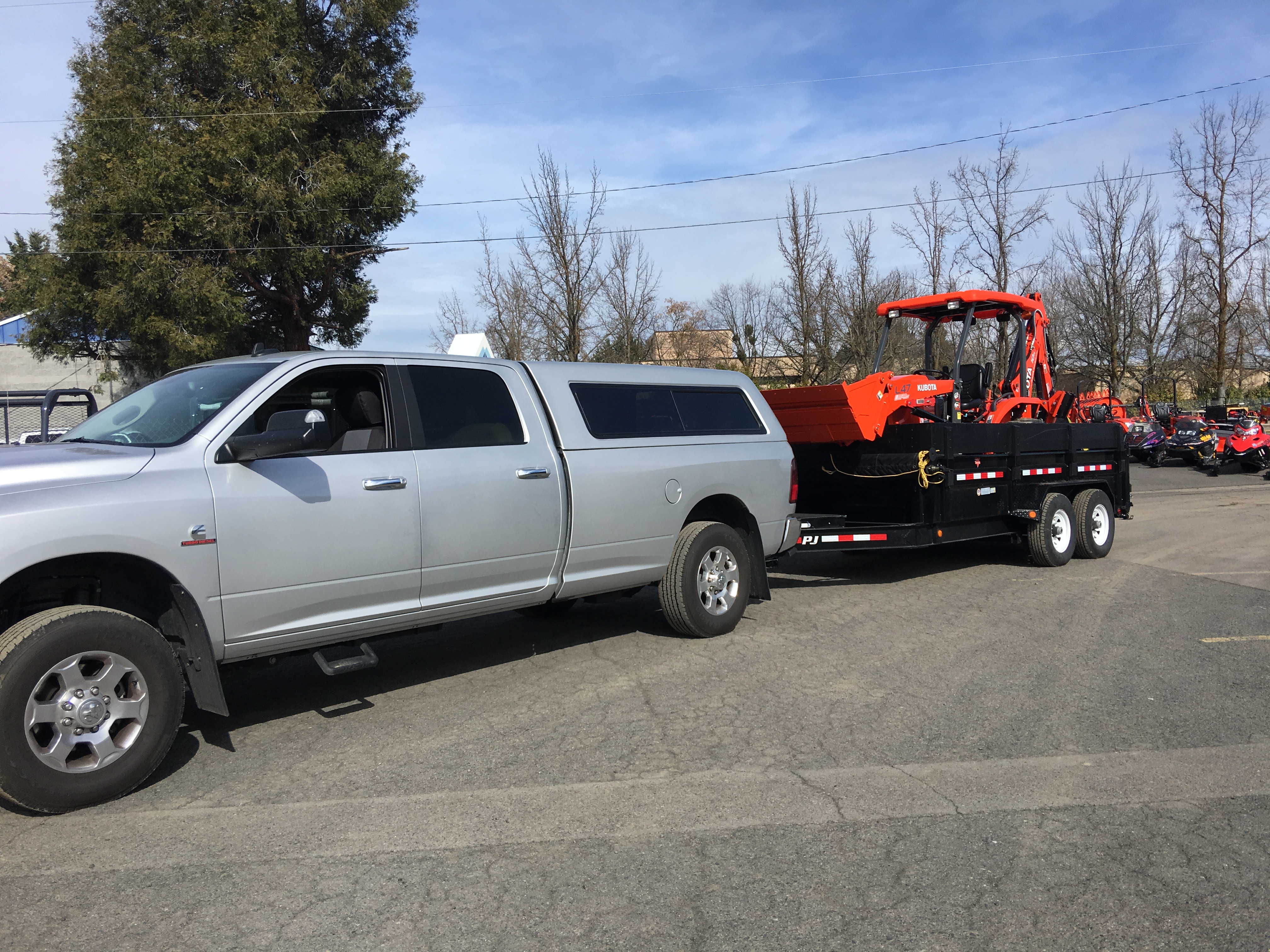

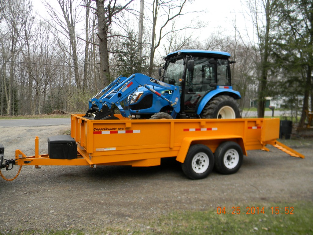

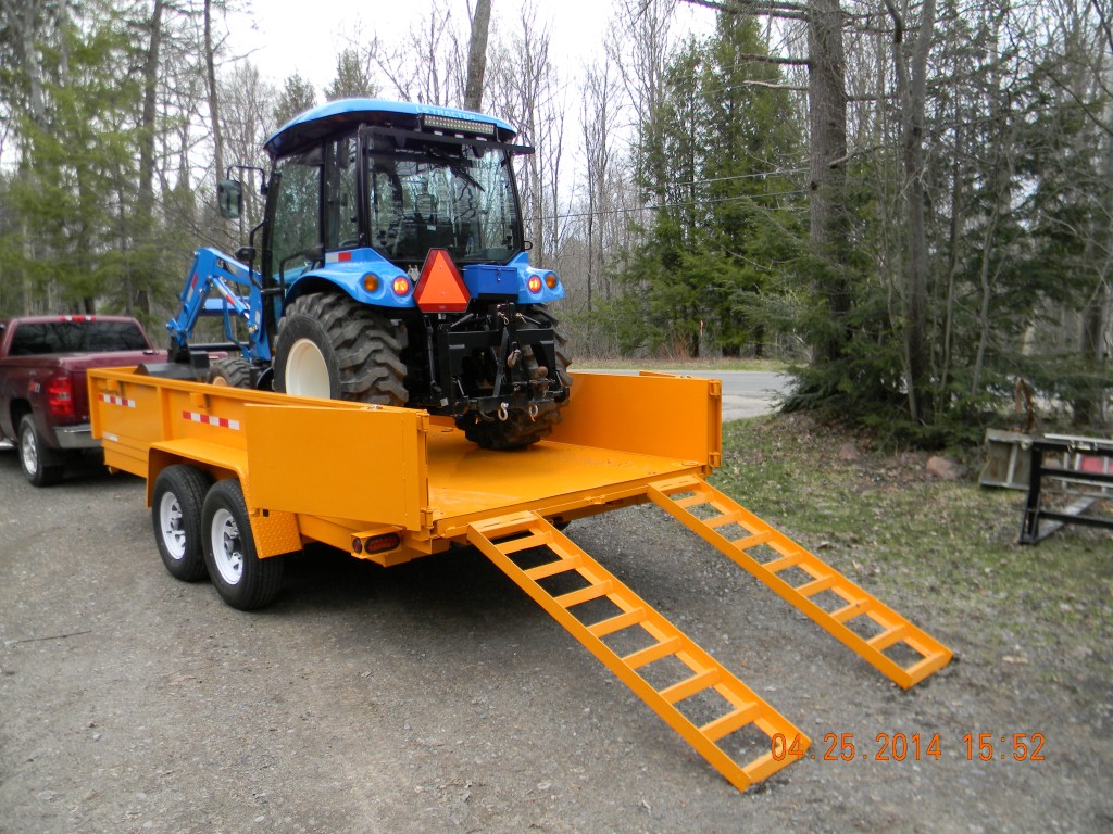

I have a 16' Cross Country dump trailer. It came with barn style swing out doors and ramps. D-rings are welded to the floor for tie down points. I can haul my 36HP tractor with a box blade if I curl the bucket to full dump position or hang the bucket over the front. If it was any shorter than 16' I couldn't take an attachment. Your 49HP tractor may be longer than mine.
I don't use mine to haul the tractor because once loaded I have to get in the dump box to secure it to the D-rings and its tight quarters to do so. Fortunately I find it much easier and quicker to tie down the tractor and attachments on my 22' PJ tilt bed trailer.
If you need a dump trailer and can only afford one trailer a dump trailer will work. Just be aware that standard length (12-14') dump trailers may be too short to haul a tractor with attachments. With a 14'er you may have to hang the loader bucket over the front of the box. 16' dump trailers are not usually a trailer that is stocked and usually special ordered like mine was.

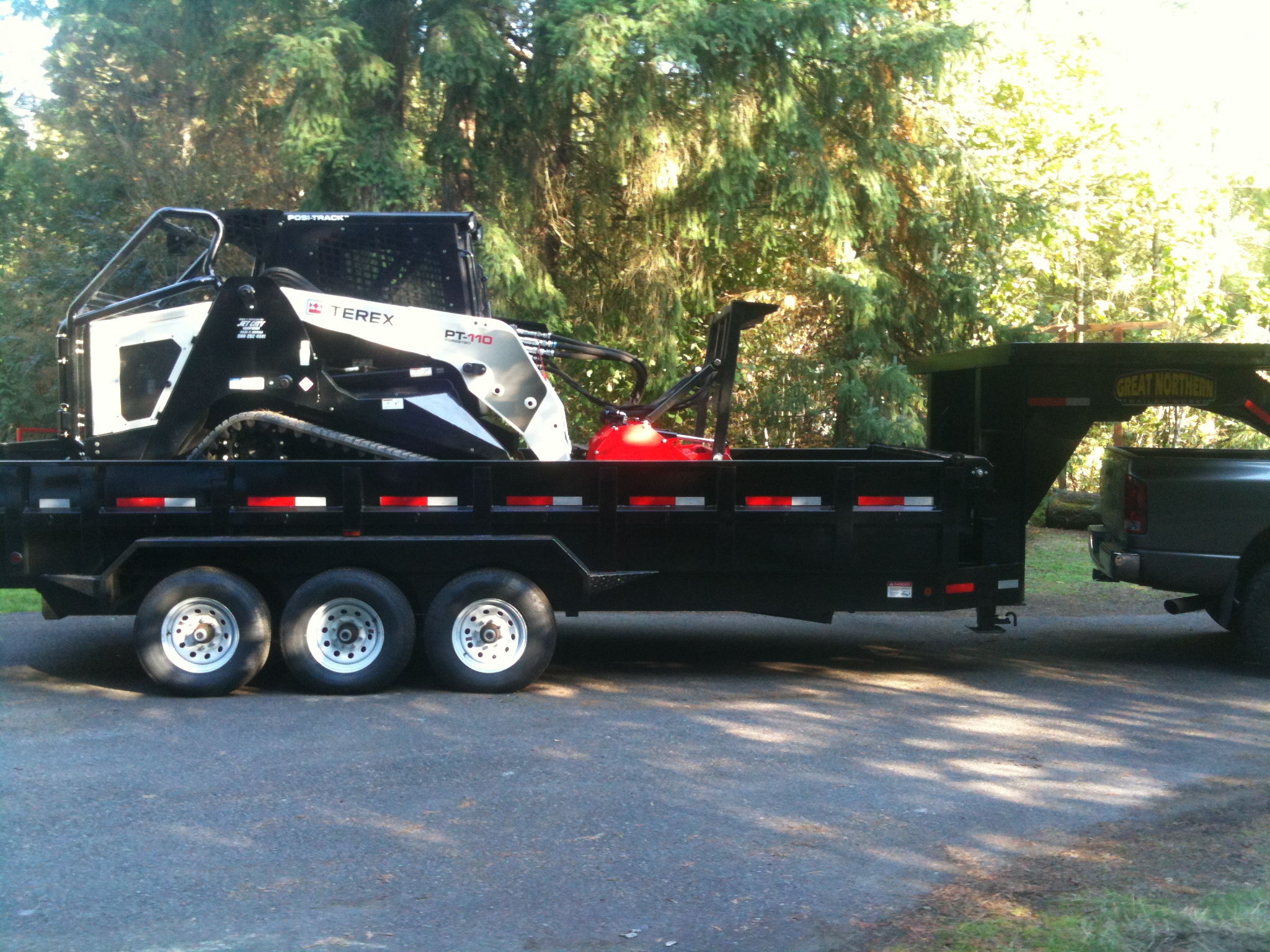

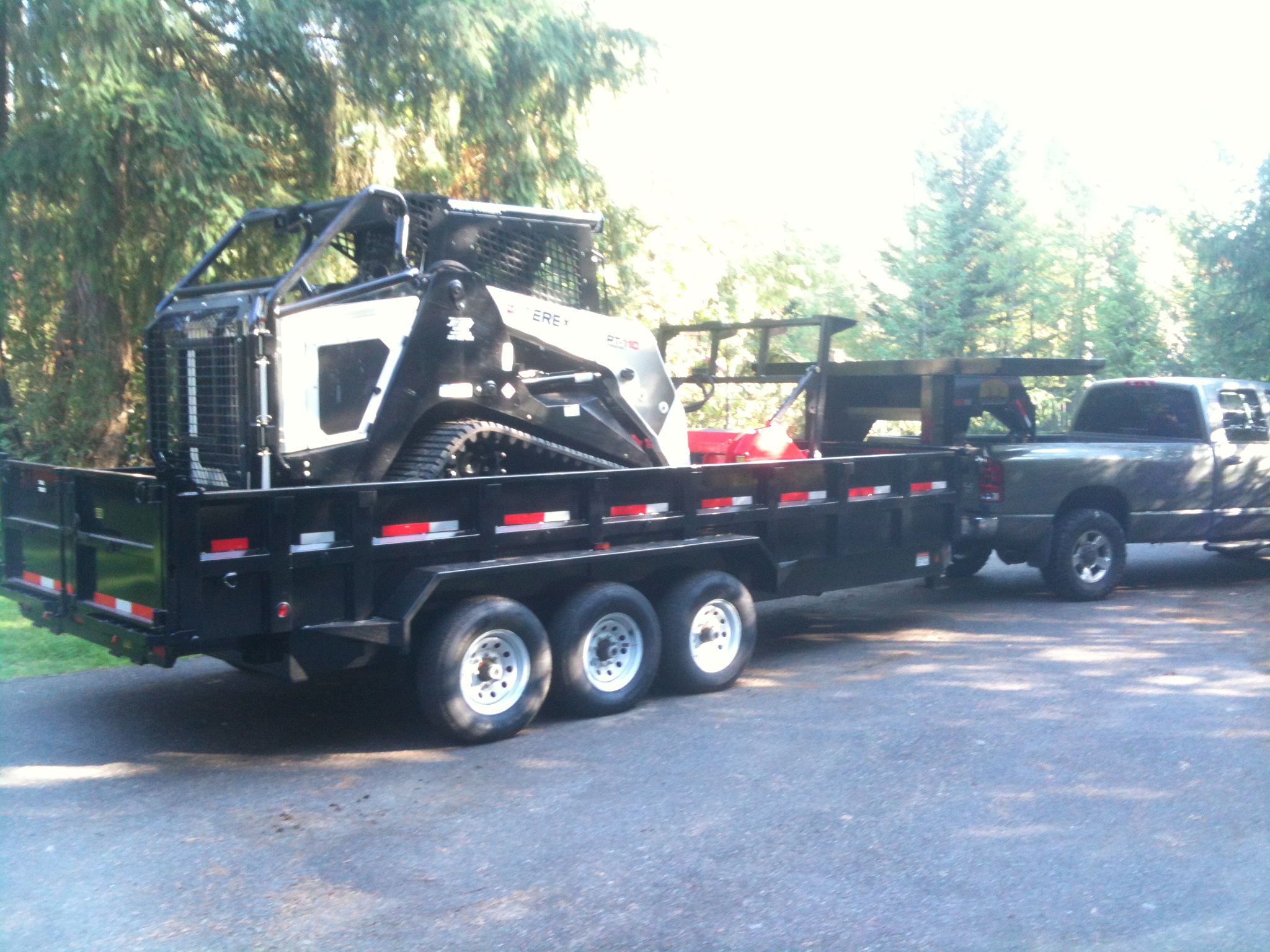

Here is what I use for my mulcher transport. Thought about another flatbed but decided to have some inter-operability.
