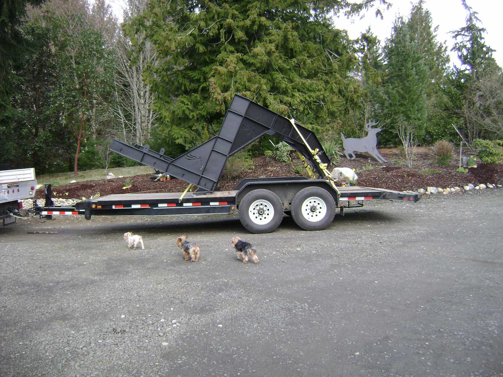

I have a 12-feet long PJ dump trailer. The factory powder coating is a joke:rolleyes:. It just flakes off in big sections:shocked:. Now this is on the outside of the box! Inside the box the powder coating lasted about 30-seconds:mad:. Couple years ago my brother-n-law who is a retired body and fender man told me to paint it with DP-40 paint. Well it didn't last long at all either:mad:!
So my question, I'm thinking about having the inside of the box sprayed with Line-X. About all I haul in the trailer is gravel, because we live on a dirt road. Never haul any sand. Anybody see a problem with Line-X inside a dump trailer?
Thanks for your opinions!

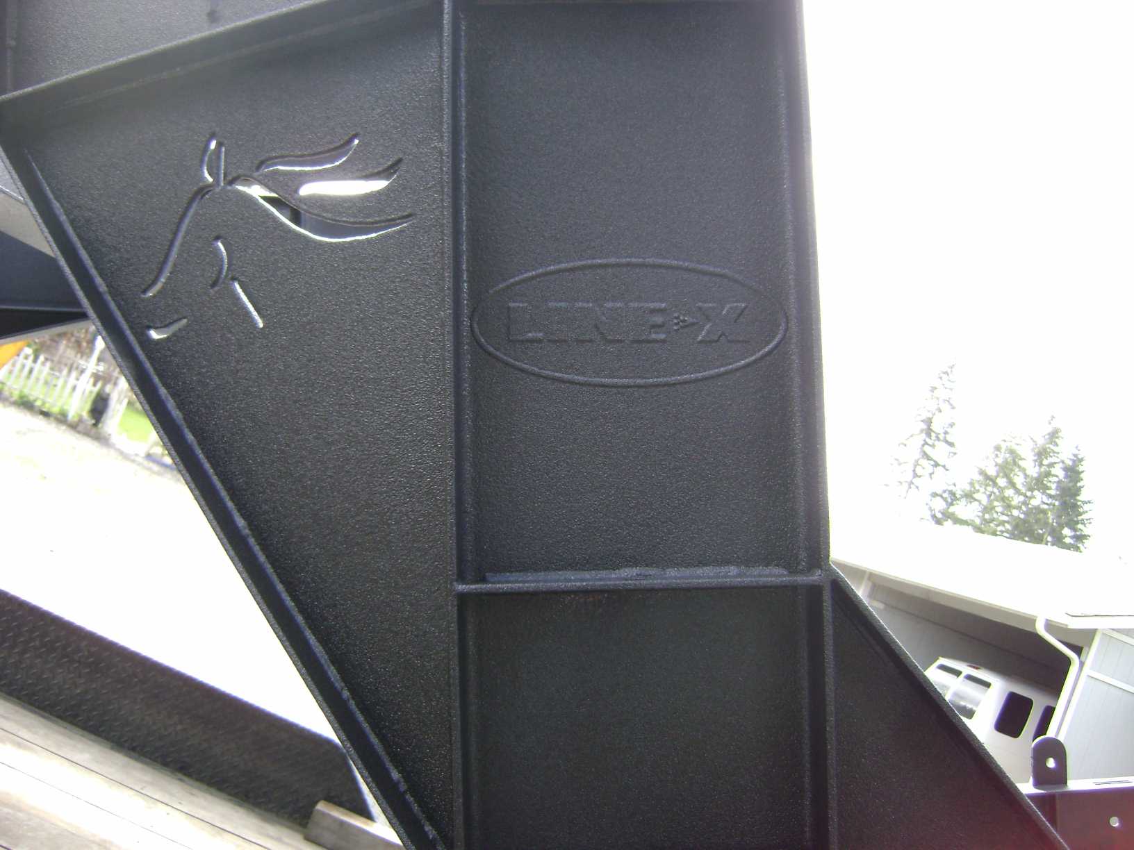

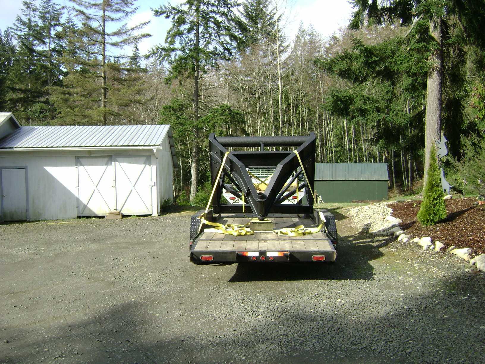

When I built my gooseneck adapter, the local powder coater wanted $2,000.00 to paint it:rolleyes:. Line-X did it for $1,100.00.
