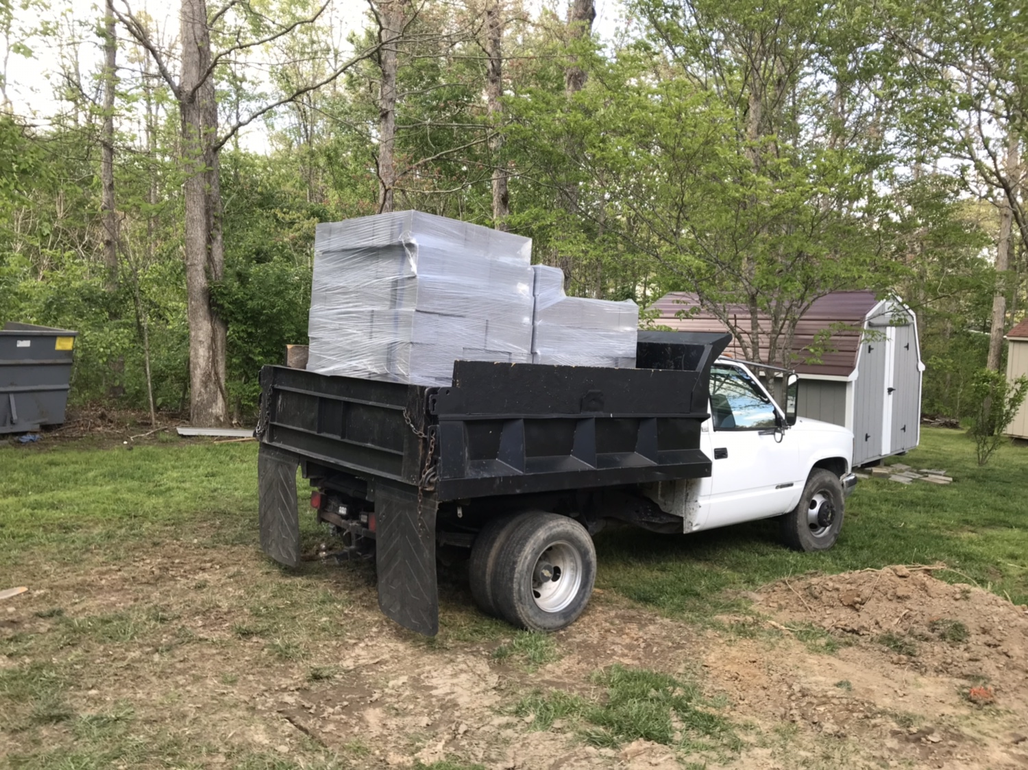

If you take the seats out of an SUV you’d be surprised how much stuff they’ll hold. I’d never go back to a pickup truck. Having my stuff dry and somewhat secure in my suburban is so much nicer. I can haul a pretty good stack of 8’ lumber with the hatch closed. If my toolbox wasn’t in the way I could haul plywood with the hatch closed. I put a half pallet of flooring in the back a couple days ago. If I have a real load I’ll take one of my trucks but the suburban is capable for most stuff. If it’s bulky and heavy stuff a trailer is better anyway. I’d like to add a dump trailer to pull behind my suburban. I hate having to drive my ton truck. Not being there’s anything wrong with it, it’s the better of the 2 vehicles but because I always need something I left in the suburban. IMG_8695.JPG
