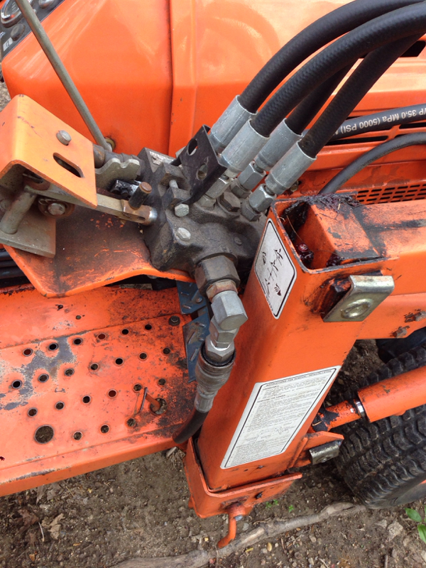

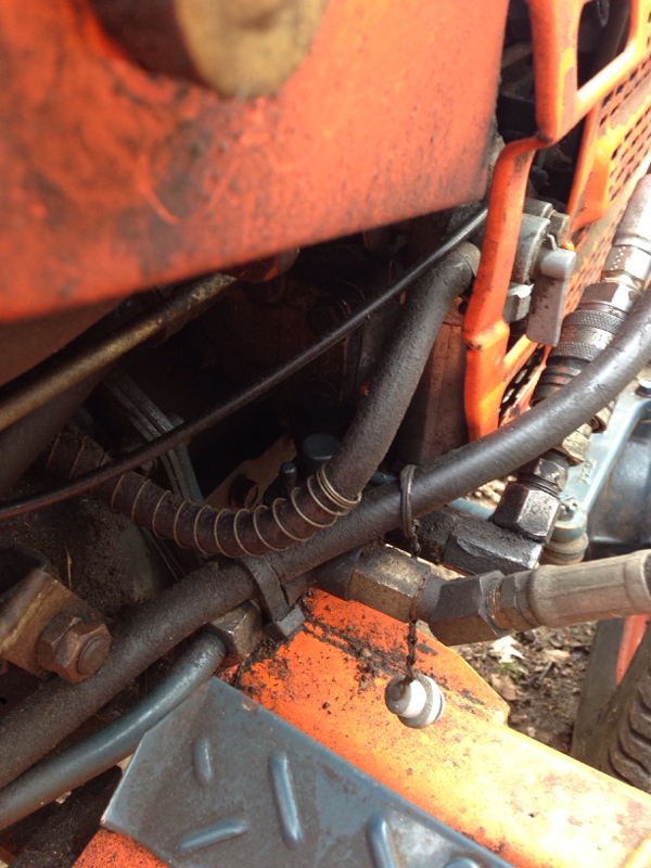

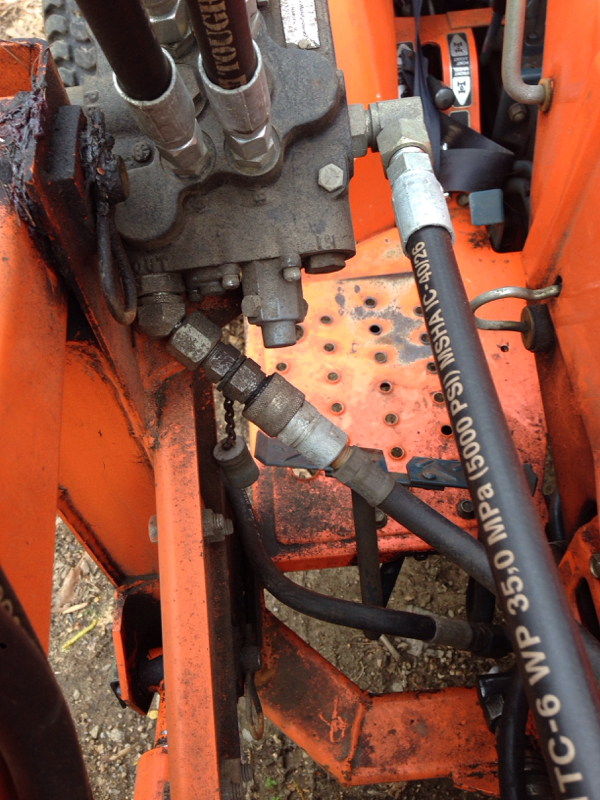

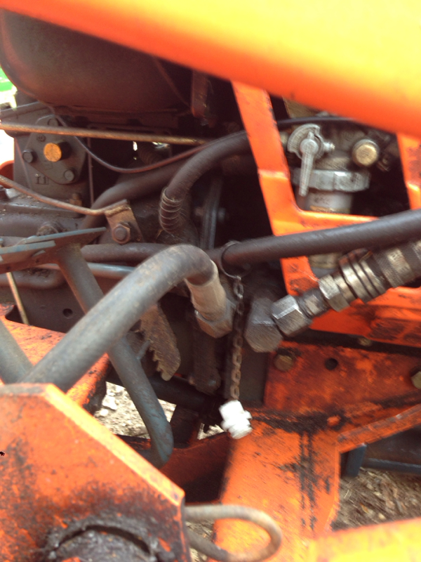

Have a Country Manufacturing 2 - ton trailer on the way. I agonized over size but went with the larger one. Will pull it behind my 3320 but also want to pull it with my kubota b5200. My 3320 has the appropriate hydraulics but would like to add the ability to dump the trailer with the Kubota. Here in lies my questions:
1) what size bore should I go with? The cylinder needs to be 24" in length to work properly. The tractor puts out 4gpm at like 1600psi(not a lot). Anyone with the trailer have any experience with this?
2) what options do I have to add a 3rd svc or diverter. Looks like a single hard line runs to and away from the loader valve and a soft low pressure return is also present. Any thoughts?
Thank You - Dana

On your current loader valve there appears to a port labeled "PB". This is in the 3rd picture and is the hose that comes out behind the loader support. If this is actually labeled "PB" it would be for power beyond and currently probably goes back to your 3-point hitch valve. To add rear hydraulics you would need to purchase another open center valve with power beyond capabilities and then plumb it in the following manner.
From your loader valve "PB" port to the pressure or in port on the new valve.
From the "PB" port of the new valve to your 3-point hitch valve. ( what the current PB connection goes to)
Tank on your new valve would need to teed into the tank line from your current loader valve.
"A" & "B" ports on the new valve would be for your rear remote quick disconnects used to operate the dump wagon.

I looked at the hoses and only saw 6 hoses so I did not think that side port is PB.
93Mustang,
Can you verify 6 or 7 hoses on the loader valve?
Oops, I looked again, and there is a hose on the bottom of the valve, so that side port is probably the PB port.
