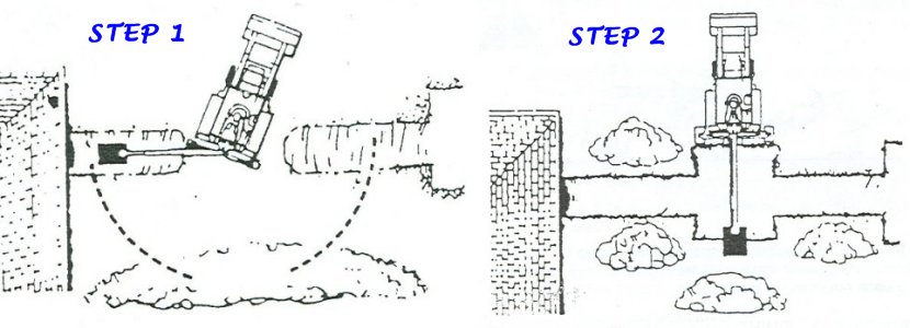

Here’s my newbie BH question…The way that I would approach digging a long trench between two points would be to start with the bucket at point-A and back up (while digging) until I get to point-B. But what if I don’t have room to “overrun” the trench with the tractor, meaning point-A is next to a building and point-B happens to be next to a boulder? Do I dig towards point B until I get as close as the tractor will allow, then turn the tractor around and dig from point-B until I connect to the trench? But if I do that my tractor will end up straddling the trench with no way to get across (without using boards)? OR do I get as close as I can to point-B and then work from the side, which makes digging a deep, narrow trench a little difficult? I’d really like to know how all you backhoe ninjas do it! Thanks.

The last couple times I've gotten into that type of situation, I just dig from either end until I get close to connecting the two trenches. Then I back up the backhoe so I can swivel both ways and connect them while sitting perpindicular to the trench. Kind of like the capital letter "T" with the tractor being the downward part of the letter and the cross part being the trench. You move more dirt this way and it's not as pretty, but it does the job.
   / dumb trench digging question #5
This is what has always worked for me.

Like most of the posters I dig from each end until I get the last bit to dig in the middle. Then the name of the game is to keep the backhoe pivot point over the trench area while keeping the tractor/backhoe stable.
Then, for the last portion, I back to the trench at a 45 degree angle. Just to the point where one rear wheel (say the right side) is at the end of the trench. This will allow the right outrigger to set down on the far side of the trench. Then the backhoe can swing 45 degrees toward the left trench side. You can then dig up about half the remaining trench.
Then move down and back up to the trench again this time at 60 to 70 degrees. The right tire rolls right up to the excavated trench and the swing pivot of the backhoe is over the trench (actually it won't be over, but very close). Then pivot the backhoe to the left again and dig the remaining trench up. I've been able to get the right outrigger to land on the side of most of the trenches I've dug. On the few that didn't, I just rolled forward (further out from the trench) and dug a wider trench. [Safety First! With some experience and if the soil is firm enough and the trench narrow enough, by angling the tractor/hoe in to the trench, you can put the tractor tire on one side of the trench and the outrigger on the far side of the trench.]
This technique will dig a slightly wider trench for the very last dig, because the backhoe pivot isn't over the trench. Depending on how neat you want to be, you will have some loose dirt in the trench you will have to remove with a shovel. /forums/images/graemlins/tongue.gif Or you can hit it again with the backhoe straight in at 90 degrees and make a slightly wider trench as the picture posted by Pineridge shows. I usually opt for the less manual labor and dig a bigger trench for the last bit. /forums/images/graemlins/grin.gif
Once again, be safe! Make sure the tractor is stable. Always support the tractor by the front bucket, cutting edge down, and the outriggers. You don't need or want the rubber tire suspension working when you are digging. Bucket cutting edge down will dig in and "plant" the tractor. Lifting the tractor on the flat bottom of the bucket will allow the tractor to move around.

I did that last week. What I did was leave a 4 ' section in the middle, then backed up to the trench like a t but 2' to the right of the undug section with the pivot right over the trench. Then I dug full left - 90 degrees to the tractor- swinging the backhoe straight out and placing the spoils on the other side of the trench. I find that it's less "effective" digging out to the side, but for the last 4 feet it works fine and I only dig the trench width that way. A little planning helps - while digging the main trench either leave a spoils free place to work from , or move them out of the way before you start the last bit so you can deposit the last dirt at ground level, rather than up on an already big pile.
With my hoe I can get the pivot directly over the trench and keep both stabilizers on the side. I've tried working on a 45-60 degree angle but I always end up with a stabilizer pressing on air that way.
One other comment - you mentioned backing up as you dig. I assume you meant moving the tractor forward - not backwards over the trench - as you dig. My experience is that every time I span a trench, I eventually end up with a wheel in the hole. My wide bucket(trench), narrow wheelbase, dirt on one or both sides and any curves, when coupled with a collapse or slippery wet dirt usually results in me "dropping" a back wheel in and needing to go get the ramps to get back out. My hoe and stabilizers can lift me back up, but there doesn't seem to be enough force to actually swing the back end out of the hole. So I lose time getting the ramps out and in place and getting out. That happened last week as well. /forums/images/graemlins/frown.gif
