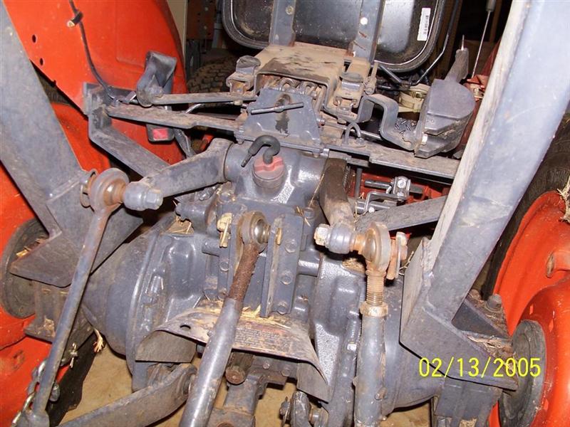

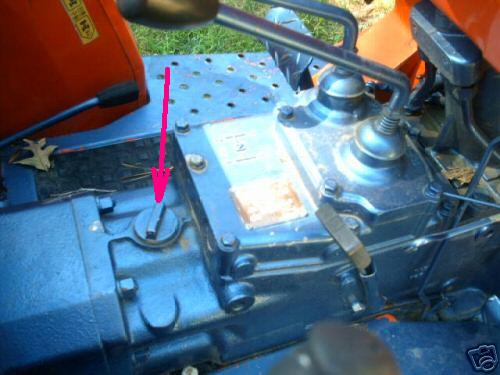

This is a really dumb question since I have owned this old beast for about 3 years... where the heck do you put the hydraulic oil into this? I have the operator manual and it doesn't give a clue, although it seems to cover checking and replacing all other fluids/lubricants OK. I have checked all the plugs & bolts around the pump and 3 point control area but just cannot figure it out!
Thanks,
Mike J
   / Dumb question on L245DT #2
The attached pic may be similar to your rig. On many Kubota's the plug is red plastic and has an o-ring. The hydraulic oil goes in the main gearcase.

My L also has a second fill point on the back of the tractor...just above the top link. It's in the middle of the picture, red cap with the hose.
I also have one as mentioned.
