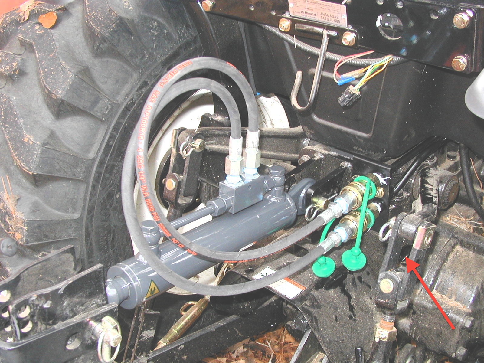

Can anyone tell me where the port is to add hydraulic fluid on a 2001 New Holland TL?
/ Dumb Question-Hydraulic Fluid #6
You might have better luck posting your question up in the New Holland forum. BUT, as you asked here I decided to look through my pics to if I could show you where it is on some of the LS models. Didn't have a real good shot, but you can see the knob for the hydraulic fluid dipstick through the 3-point linkage in this shot:
