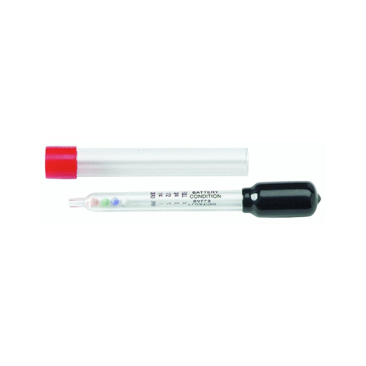

Sounds like a battery with a weak cell. Battery charger will kick off if voltage drops too low to avoid a short circuit. Buy a $1.99 hydrometer (eye dropper electrolyte specific gravity measurement tool) from your local autoparts store. Test each cell by suctioning the liquid into the eyedropper. Bet you one of the cells will have 3 of 4 cells sinking. Will take you 2 minutes to do this.
Amazon.com: Custom Accessories 46665 Battery Tester: Automotive
A battery with a weak cell will seem to be OK, and can have a no-load voltage of 12.5-13.5V, but as soon as you put a load on it, the weak cell drops down to 0V (and then reverses polarity). Voltage measurements of batteries under no load are essentially useless to determine state of charge.
Even a so-called "starting battery charger" promising 30A output won't help in this scenario. The battery charger won't be able to maintain DC voltage high enough to keep the solenoid engaged.
