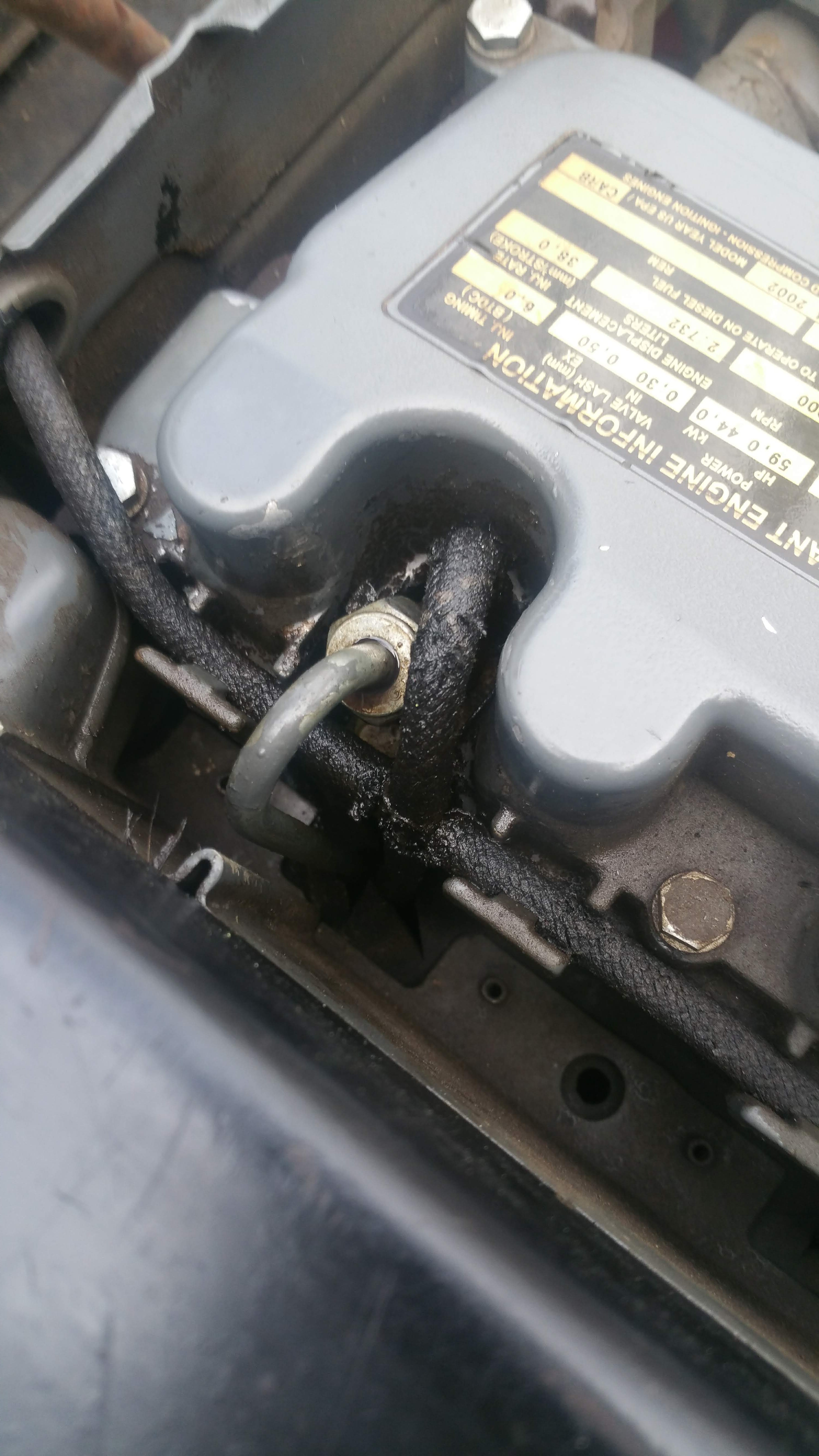

If you have the Duetz diesel 1101/2011? And maybe others, I would check the fuel return lines for slight leaks/wetness.
I had a small pin hole leak in the number 1 return line and it was spraying fuel into the engine bay.
Only reason I noticed it was because I was checking for something else and I saw wetness sitting on top of the oil cooler housing when I opened the engine cover. The wetness was deisel fuel.
Cleaned it off and let everything cool down then ran the engine and I saw a little fuel spraying out of the return line from a pinhole leak.
NOT GOOD! Seems this happens when the lines get older. Mine return line tubing definitely looks worn/frayed.
Would recommend checking and replacing if your return line is older.
Kit for 99.00 from Foley engines has all the barbs and the proper fuel line.
I hope my barbs are ok and I just bought the return line off ebay for 12.00. (Tee vw fuel line 3.5mm diesel yellow stripe braid injector TDI return GERMAN oem)
Hope this might help someone else in the future.

Well at least it wasn't spraying gasoline!
   / DUETZ 1101F Fuel return line leaking danger #3
I had a line break and didn’t notice it until there was a strong smell and a Smokey haze. Diesel is very hard to catch on fire. You need to really atomize it and get it into open flame or pressurize the heck out of it before it goes off. That all said it isn’t any fun when you blow a hose. Both ken an I have run new lines doing the same thing you did Probably will replace them again in 5 years.
   / DUETZ 1101F Fuel return line leaking danger #5
Literally found the same problem Friday. Replacing the lines today. Thx as always for posting.
