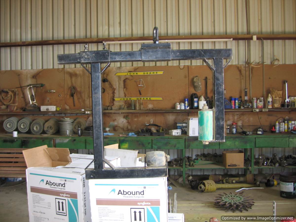

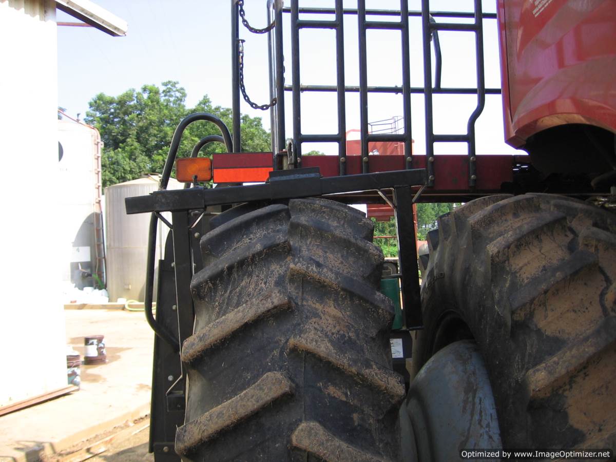

I built this for a farmer friend that duals up his tractors in the spring for land breaking.I used the rollers off a cotton module builder to spend the wheel in order to line up the lugs 017.JPG015.JPG.He parks the inside wheel on a block of wood and then suspends the outside dual with a forklift using it to line up the lugs for install.Im a pretty good welder fabricator but suck at posting pics as you can tell.

Nice of you to do so. You do not think about things like this until you have been fighting one side for half a hour and not lined up anything.

much easier process than trying to jack up the tractor and get the tire rotated just right to line up the bolts.
Nice job digger nut
