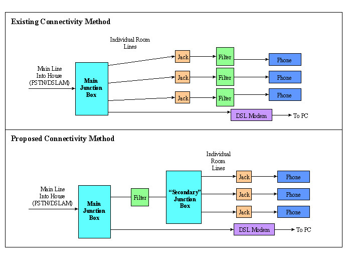

Seemed like it should work to me, just haven't had the need to try it (i.e. I don't have a DSL connection or fooled with DSL CPE stuff before.)
I've never had the chance to "pop" open a DSL filter and see the contents, but I figured (correct me if I'm wrong here) that it functioned like (perhaps even using similar components) as a passive crossover network as used in the world of audio.
In the world of ADSL, it's my understanding that everything below 4kHz is still allocated to voice (POTS) while 26kHz to 1.1mHz is dedicated to data (with 4kHz to 26kHz being "no man's land" because of the high-pass and low-pass filters).
If I'm off base with my analogy or specs, let me know. Always open to learning something...
BTW, attached is a revised (i.e. corrected) version of how CPE xDSL could be set up, at least as I understand it.

Maybe my revised picture will make more sense (posted above).
Think of it this way - in your scenario, if you bought a, say, 1-to-3 phone jack adapter (see attachment) at Radio-Shack (male one side, 3 females on the other) and then plugged that in to the "Phone" jack on your splitter, then hooked up 3 phones to that 1-to-3 way adapter, you could have 3 phones operating and 1 DSL modem operating - all without buying any additional filters/splitters.
Essentially, my diagram (revised one) is intended to communicate that, but instead of being on the outside of the wall, just imagine it takes place in your attic as all the phone lines in your house should be wired back to a central point somewhere - i.e. "junction box" and 1-to-3 adapter = "secondary junction box." (even if they weren't, it should still work, but I don't want to complicate the matter as the principle I was inquire about would still apply.)
Anyway, hope this clarifies my question -

That adaptor will work but I think it's doing it the hard way.
You home/office is already wired with phone jacks, hopefully where you want them. All the jacks are wired back to a central point called a demark by the phone company. You need to find the demark and do all your wiring on your side of the demark. Look for a grey box either outside on the side of your house or maybe in the garage.
There are almost too many possibilities to go into detail on how exactly how to hook everything up but basically what you want to do is disconnect the house wiring from the demark, run all the wires plus a new wire from your side of the demark into someplace where you can get to it out of the weather and make new connections. Go to Radio Shack and get 2 or 3 surface mount modular jacks to do your hook ups with. You want to put the splitter between the wire coming from the demark and your house wiring then all you need to do is connect your DSL modem to the DSL side of the splitter.
And yes a DSL splitter is simply a passive filter. I am better at doing than explaining to someone how to do...

Your proposed example is exactly the way it should be wired.
The splitter is a special whole system filter and is the way that I had the phone Co.
set up each of the two DSL lines at my house! This works better as each
separate filter can cause a decrease in your speed. There is also a limit as to how
many filters you can put on a line without causing problems.
I have rewired many systems this way resulting in up to a 20% increase
in speed. I do small office and home DSL setups plus networks
and this is one thing that I require on any system I install.
Just be sure you get the right filter/splitter!

I agree - I wasn't recommending using such a device, just trying to explain (in principle) the connectivity model using the items KubotaSteve mentioned. Talking to a couple of different audiences here in this thread I suppose - which can make things a bit muddled at times.
I am familiar with the concept demarcation points - and although my "quickie" diagram didn't label the anything as such, it is in there.
I agree with your point that there are too many possible combinations of wiring, equipment layouts, etc. to illustrate all possibilities - but I really wasn't trying to do that - really just trying to illustrate the question I had regarding if a single filter/splitter would work for multiple POTS instruments and thereby eliminate the costs associated with having to buy multiple filters.
BTW, thanks for confirming my understanding on how the filter worked.

Thanks for the info. You have raised my curiosity a bit with regards to the multiple filter aspect...
Specifically, I have 3 questions:
1) How do the extra filters hurt the signal which causes a reduction in speed (attenuation??)
2) Do they cause problems even if the voice instruments aren't off-hook?
3) Are the limits regarding # of filters standard or are they developed by the LEC for their specific implementation of xDSL?
