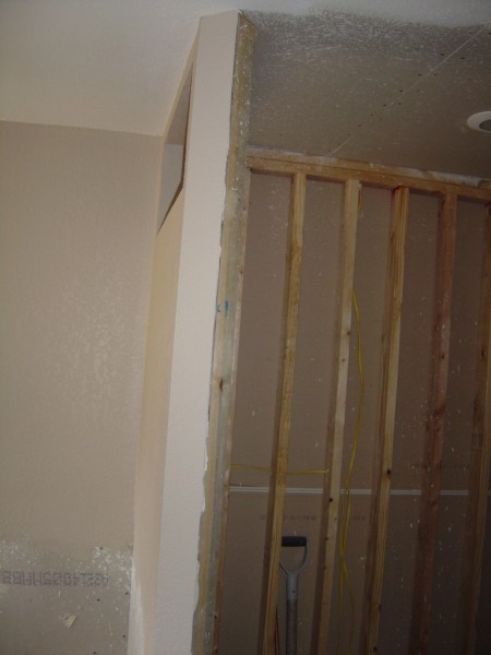

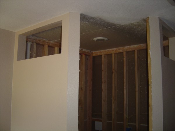

Your timing couldn't have been any better, for me to be able to take photo's of what i did for the exact same thing.
I've attached two photo's. To make a long story short, use the cement board all around your shower opening, whether it gets tiled or not. The cement board can get tape, bedded and textured just like the regular drywall.
On the first picture, the insides of the "light window" into the shower was done with cement board. Then it was tape, bedded and textured, so it matches the main walls. Also the very short parts of the "Hypotenuse" was also done with cement board and tape, bedded and textured. Anything that you think might remotely be in contact with water or has the potential to wick some moisture, I would do with the cement board. The inside of the threshold (hypotenuse) to the shower will also be cement board (but will get tiled, instead of textured) as will the shower itself. The shower I'm building is 6' x 6' and has two complete shower sets. The pan will be a one-piece cultured marble, custom pan. Look into a "pivot" style door, rather then a track door. Your local glass dealer can build a pivot door. I think they look cleaner because they have less hardware (no track etc.)

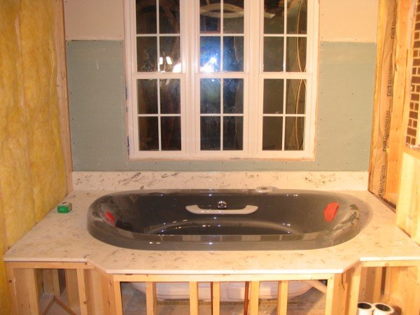

The second phot is of the same area, from a slightly steeper angle. To the far left of this photo, is the area where a drop in jacuzzi tub will go. The wall is cement board half way up (tile surrounding the tub) and then is moisture resistant board the rest of the way up. I had the tape,bed and texture lap slightly lower then the finished tile height. Once I fugure the actual tile height and snap a level chalk line, I'll take my DA sander and clean off the texture to that line to allow a secure backing for the tile.

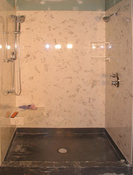

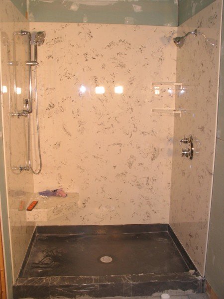

I just got the pan, walls and tub set for my project. Cultured marble pan and walls (48 x58) plus tub deck (72" air tub). I used green board. The way the pan is made, it gets fastened to the studs, then you apply drywall (or Durarock) from the pan lip to the ceiling, then the wall panels are set in place.After setting the pan to the framing, I needed 1/2" between the studs and the marble. None of the local suppliers had durarock in 1/2".
The subfloor under the pan needs to be completely leveled too. Did I mention that the marble pan is HEAVY!

Tlbuser, just messing around. Thought you might like to have this perspective corrected shot for your project record.
