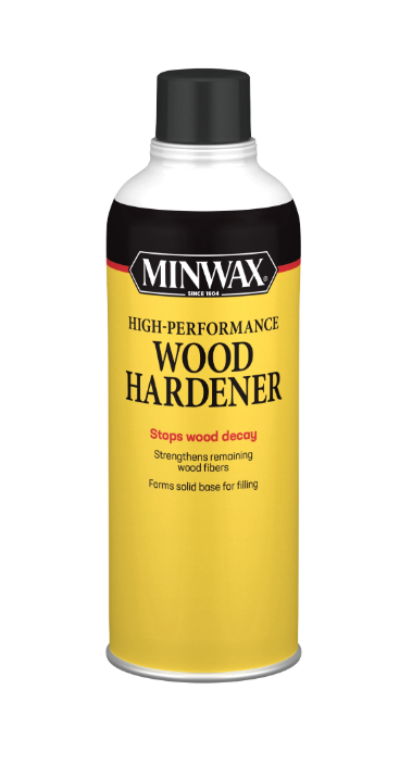

Obviously, the repair method depends on the extent of the damage, but for relatively small rotted-out spots I'll usually dig out ALL the rotted wood, treat it with wood hardener, then fill with an epoxy wood filler. If it's too far gone, you'll probably want to replace the rotted wood.
I have done the same on rotted window sills, dug out rot, used wood hardener, built back up with new wood, treated that with hardener and then finishing build up with wood epoxy
If you’re wood has any decorative features you can mould the epoxy and then sand to match after it is hard
