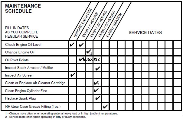

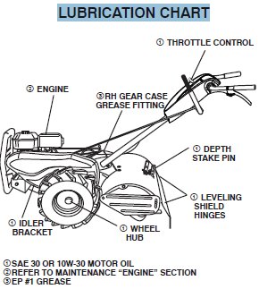

I have a DRT900 as well. I was looking through the manual and I don't see anything about transmission gear oil. In addition to the oil fill plug, I see two others.
I used it a little last year (1st year) and only checked the engine oil.
I changed the engine oil this year, but now I need to figure out what these other ones are. I don't want to tear my new baby up!
Can anyone help me?
   / DRT 900
I have a DRT900 as well. I was looking through the manual and I don't see anything about transmission gear oil...
If you look at the right side of the transmission looking from the handle end, you will find a grease fitting. The manual says to grease the trans once each season with EP #1 grease.
Hope this helps.
