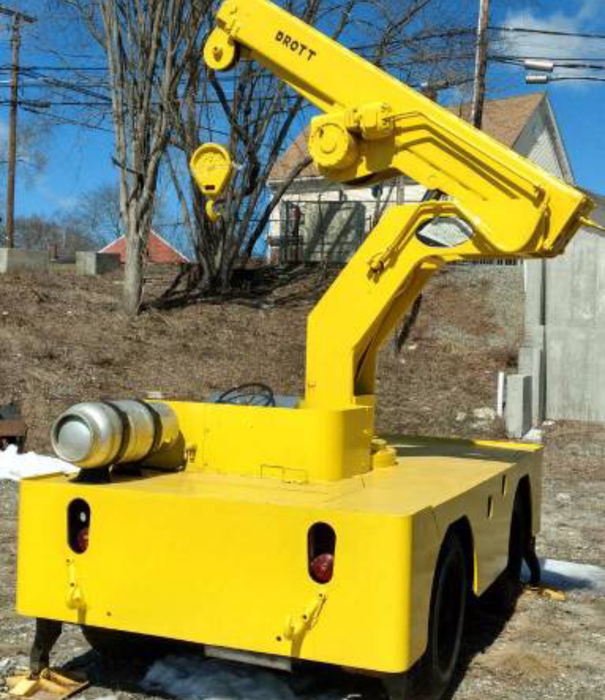

Brought home a Drott 85RM2 "Go Devil" carry deck crane today. 60's vintage (serial #570). 8500 lb rating. 16' working radius. Starts and runs fine. Cylinders all good. A few oil leaks here and there, several grease zirks painted over. Going to give it a good lube and check fluid levels/change oils/fluids. Needs a set of 9.00 x 15 tires. Powerking still offers them. After I'm sure the mechanicals are good I'll replace them. It's been a yard crane for a welding/fabrication shop for the last 20 years or so, mostly kept indoors when not at work.

Due to a host of other projects, I have not had much time to work on the Drott over the summer other than order the parts and service manuals. I was able to download a manual for the Continental F163 engine yesterday. I did get into it a bit this weekend. Made a modification to the power steering pump bracket to allow for a little more belt tension. Found a new oil filter in stock at my local Advance Auto along with 4 new spark plugs. I plan to change the oil tomorrow, weather permitting. Cleaned the air filter element too. Needs a grease job but first I have to clean off all the zirks, they painted over everything!

Oil Change complete, oil was very dirty, but no water or antifreeze present. Took the opportunity to remove & repaint the filter canister. Also changed the spark plugs and did a compression test on the engine. 120 lb to 130 lbs. I was pretty happy about the range. Engine temp gauge was not working, the wire lead had come loose at a crimp splice. I'll repair it tomorrow. Power steering doesn't squeal anymore. I painted the underside of the two engine compartment plates. I'll give the top sides a couple of coats tomorrow too. Next up is cleaning the grease fittings and giving it a good lube.
