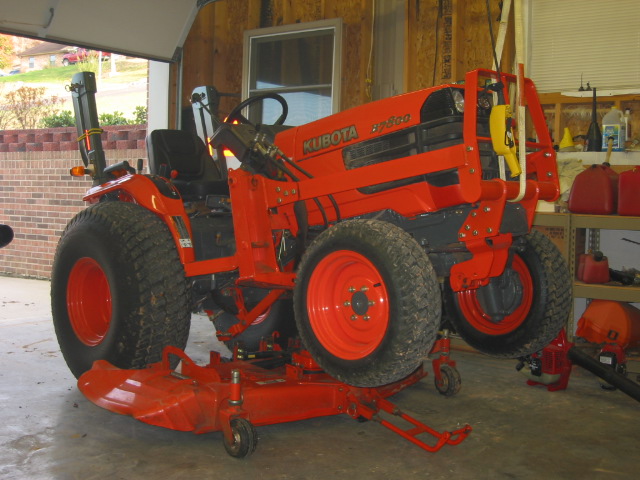

I have a G1800. I used to drive over the deck to install it. The deck is strong enough to take the weight of the tractor so no problem there.
I used to drive up and almost over, small ramps help or the front wheels kept pushing the deck away, but I'd then lift the front of the tractor with a car jack and gently lower it down. I was really afraid that unless just right, driving over and dropping down on the other side I could end up with a punctured oil pan or worse.
I now use my FEL to lift the front of the G1800 and I then slide the deck in from the side.
You can drive over the deck but it's a risky move.
   / Driving over mower deck #5
Yes, you can drive over the deck, but you can also turn the scalp rollers sideways and just roll it out. You don't have to lift the tractor with the FEL either as there is plenty of clearance.

IMO, its more work to drive over it than it is to just pull it in from the side.
I'll never pull another MMM. That within itself is a pain in the rear. If there is ample room to gracefully pull a mowing deck without frustration, I'll eat my hat. Exempting my method as a result of a first and last episode of the easy-glide method... (not).
