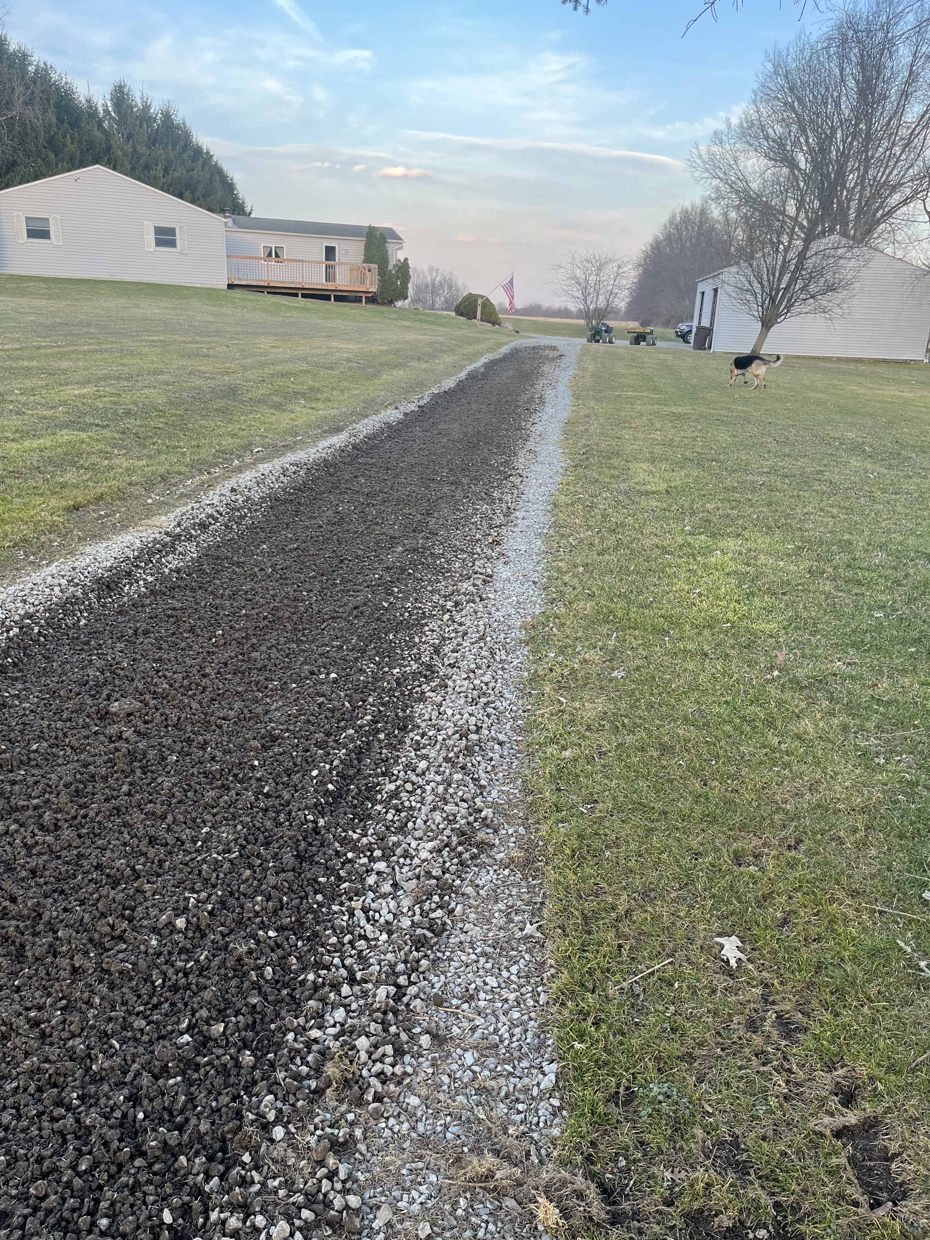

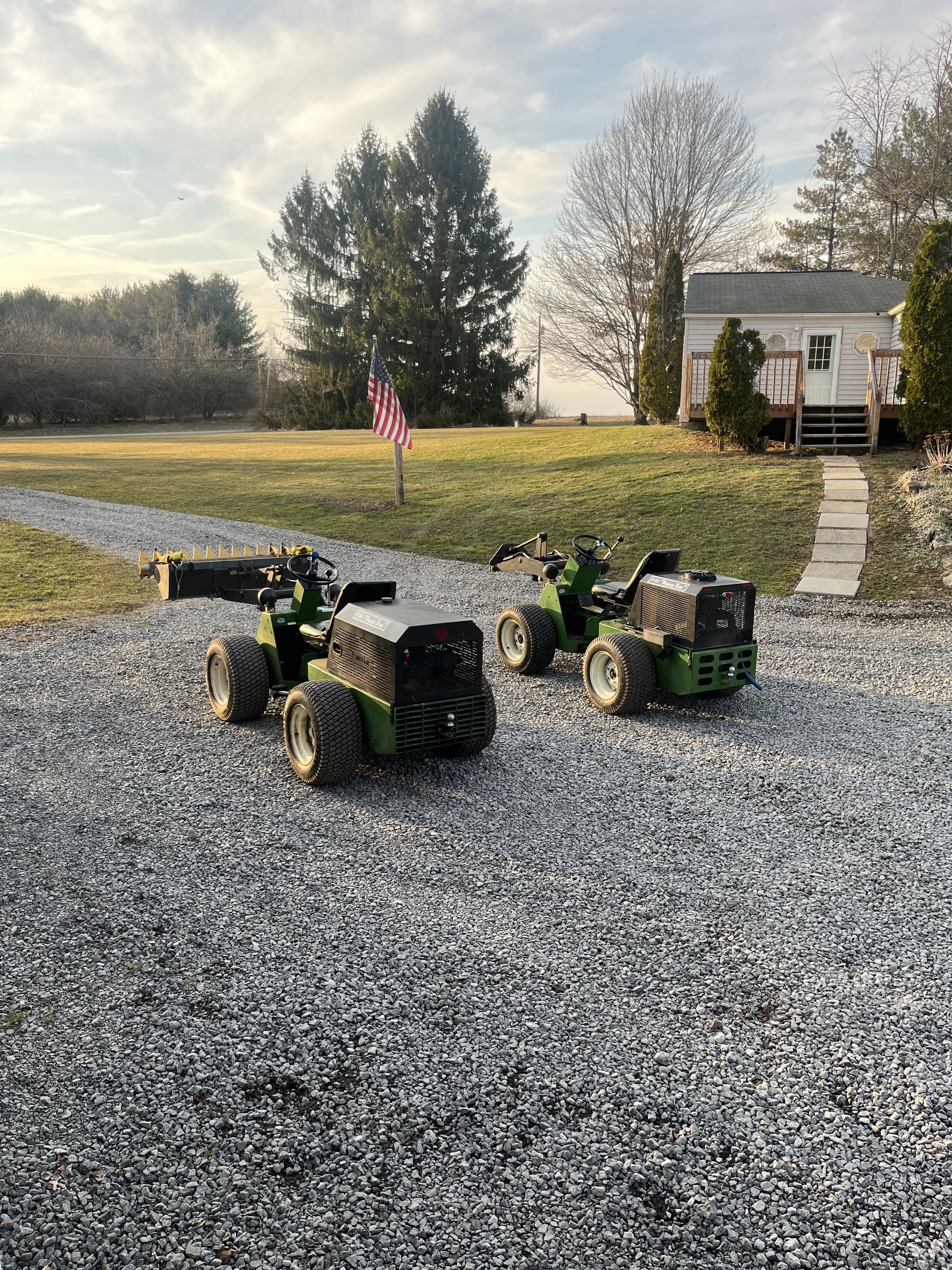

Hello,
I’m thinking about getting the power rake for my PT422 for maintaining my gravel driveway. Right now I use the ratchet rake that attaches to my bucket ($300.00) when I bought it three years ago. I Was wondering if any of you guys have the power rake and would recommend it for a gravel driveway? It has a hefty price ($3500.00) any advice would be appreciated.
Thanks
   / Driveway #2
Only my opinion, you have the wrong gravel. You don't have fines to lock the rocks together.
I rarely touch my driveway once I fixed any pothole that was from the previous owner.
You definitely don't want to break up the driveway base.
What problems do you have where you need a power rake?

I don't have the power rake, but my impression from talking with folks that have one is that it is intended more for soil preparation for seeding lawns and the like, as the power part of the rake tends to fling gravel. Once the camber is set, I think for driveway maintenance a land plane or a box blade is more useful.
@maddmatt16052 this is definitely armchair quarterbacking, but from a zillion miles away, I think that @old and tired is on the money for your driveway needing fines to hold it together.

My neighbor has a Harley rake, or power rake. Two passes on my driveway and all the potholes were gone. I was very impressed with it. Thought I might get one, but they are over $10,000.
I bought a land plane instead. It does a good job, but I should have bought a bigger one for the JD.

I have a power rake. Use it more for soil prep but I think it would work well for your driveway. The caster wheels make it level easier and faster, plus driving forward instead of back dragging.
Also have a tiller. It is a poor choice for grading.

As to the gravel type, in VA, it's called "21A." It's 3/4" minus with fines (often including some clay as a binder). Great stuff. You could probably just add a couple loads of fines since it appears you may already have the 3/4" minus, but washed and no fines. The gravel pit or delivery guy should be able to make a recommendation.
Instead, you might consider one of those Harbor Freight plate compactors before buying gravel or a power rake. I have one and they do a pretty good job. You could also rent something, such as a rolling compactor, and try it. Depending on your gravel base, and what exactly you're wanting to accomplish, a compactor can yield some good results.
