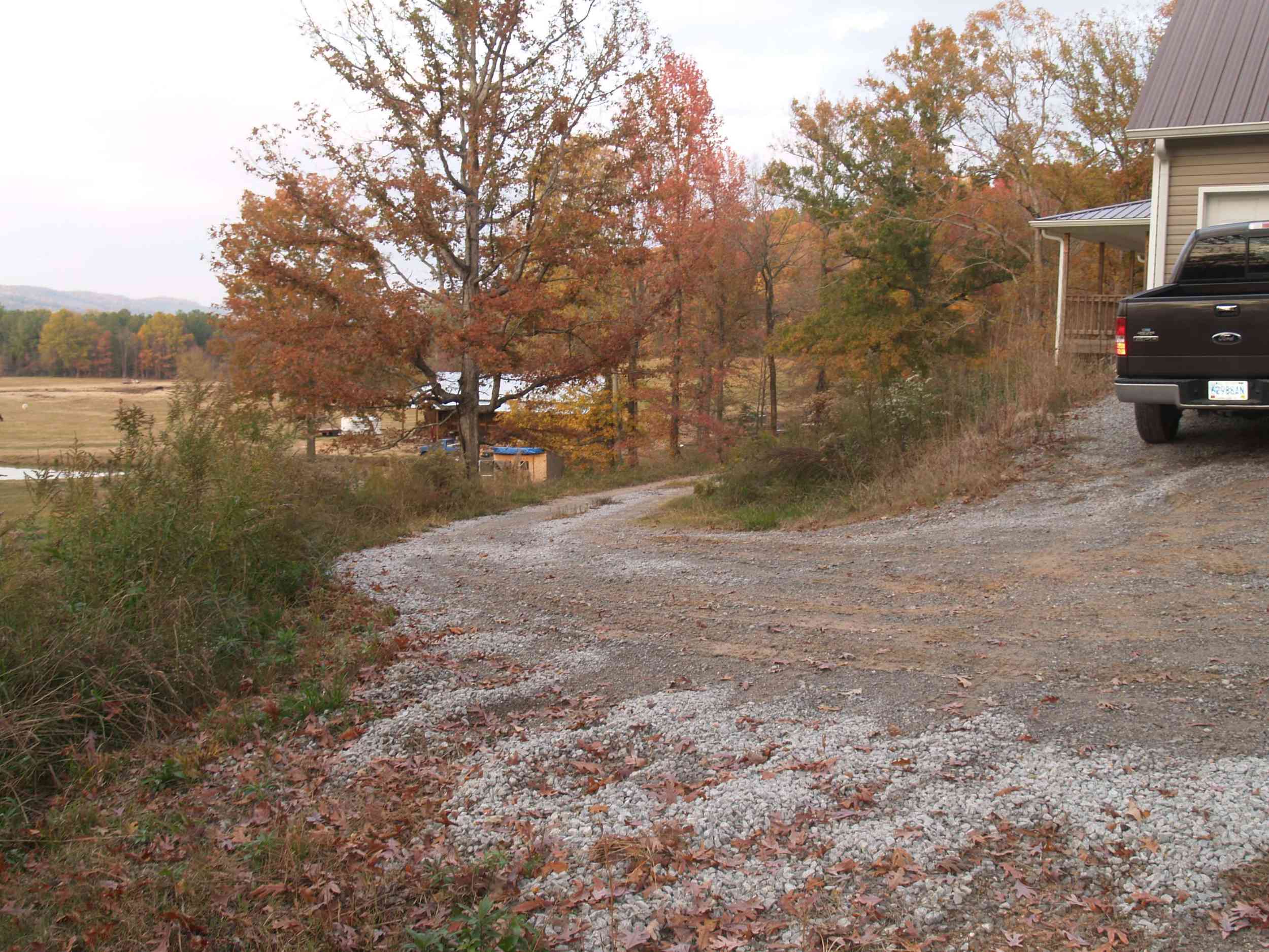

Thanks everyone for the info. I have tried to search this forum for information about using a rear blade, but keep getting an "internal server error.":mad:

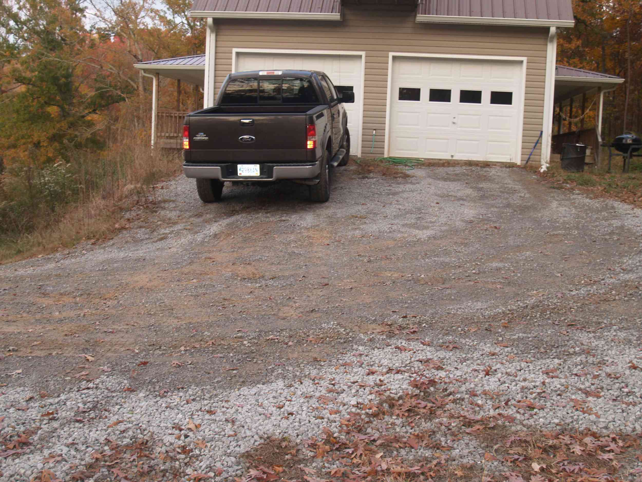

Here are the pics I took last night - just before we got some much needed rain.
You can see much of the gravel has been pushed back to the edge of the drive and into the area between the garage doors.
More of the same.
You can see that the gravel has been pushed to the sides of the drive and into the middle, over a small crown. There is a ditch on the right and a good drop off on the left. The ditch is full of weeds and needs to be cleened out. Not one of my favorite jobs.

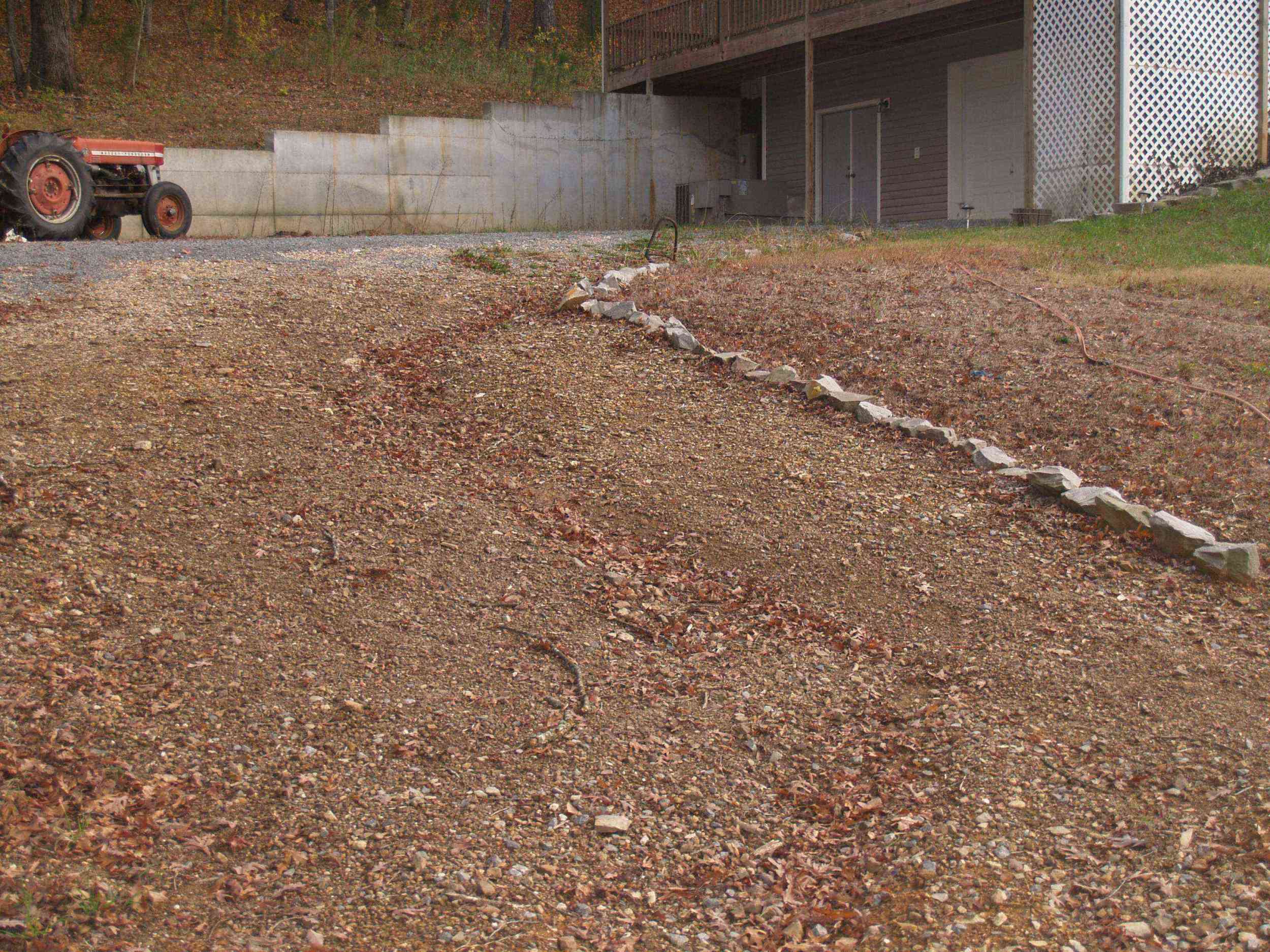

There is some damage do to run off from the down spouts. I have a plan to solve the run off issue by connecting the down spouts to that black pvc pipe and running the pipes to a culvert that will take the water away.
More of the run off damage and the Massey 135 I use around our place.
