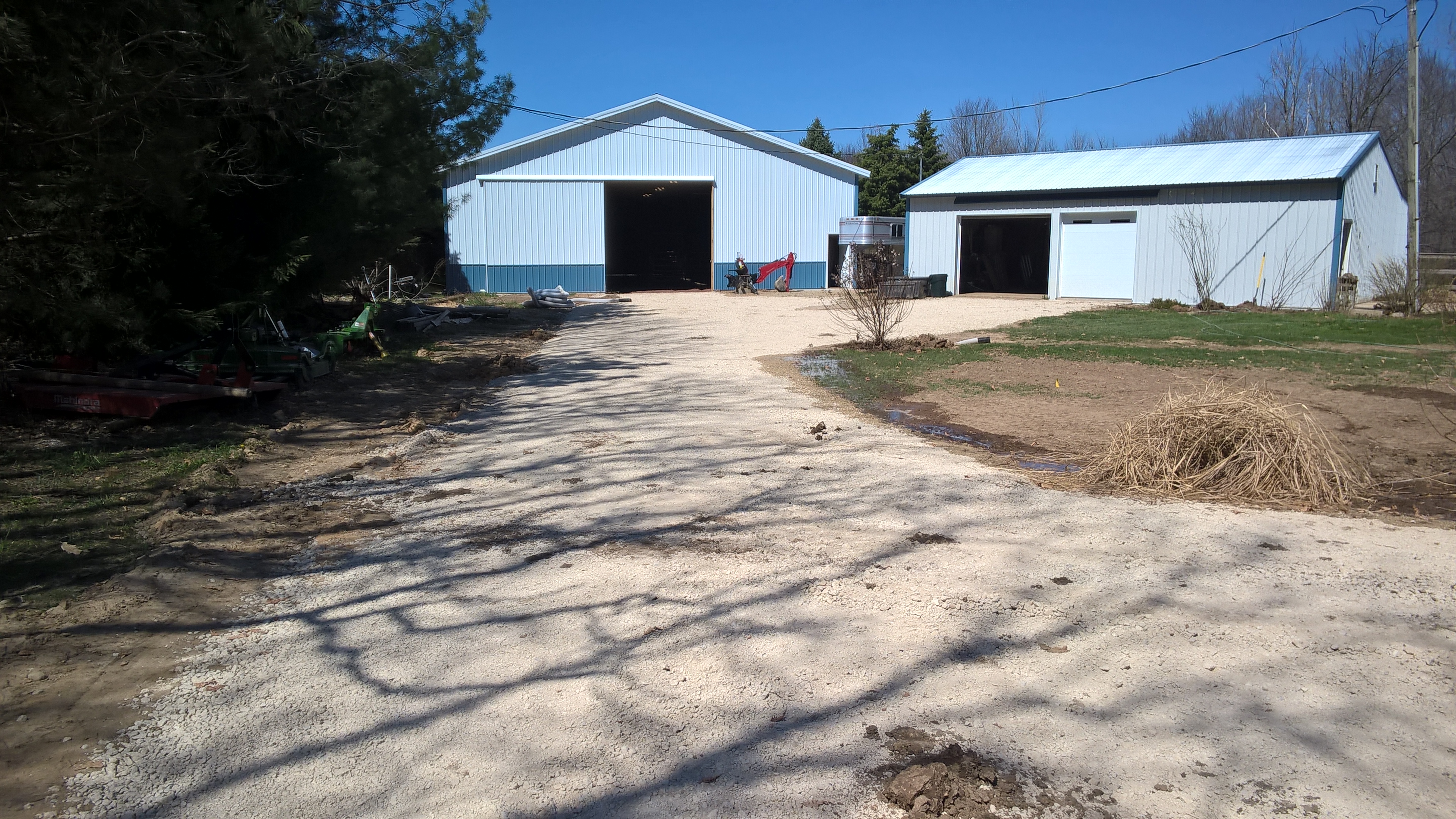

Added a new barn last fall for the animals and opened up the existing smaller barn for use to house the tractor and pick up. The spring thaw was fun and realized that a new drive was necessary. Needed to add a drain tile as the ground was mostly clay and the water would settle there. Called Miss Dig prior to trenching and put in about 100' of 4" corrugated pipe covered with 1"-2" stone. It rained that afternoon and the outlet had great flow. Covered it with crushed concrete. Now a matter of time and driving on it to get it packed in well.
