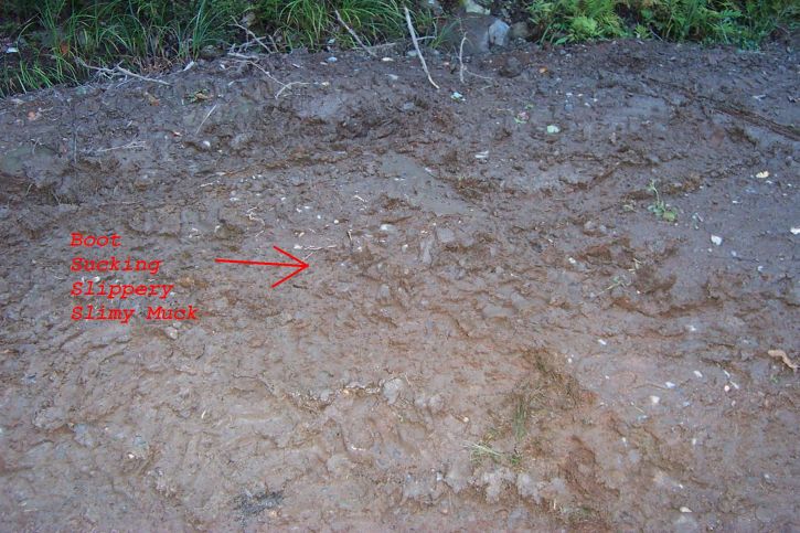

I am moving forward with the parking area. The stumps have been removed & large rock removed as well. I have created an approximate grade of 1/2" over 10' towards the existing ditch around the perimeter of the property. My help request now is that I am into a slippery, slimery muck that will suck your boots off (see attached pic). I scraped the topsoil off when creating the grade but maybe it was deeper than I saw. My tractor will not even turn in this mess that is how slimey it is. Should I put the landscape fabric down now or a layer of crushed rock first. If I put crushed rock down, I'm sure it will disappear but maybe that's the point, yes/no ? What are your experiences when creating a good base & working in my type of conditions ? Thanks

Hopefully, you mean 1/2' instead of 1/2" in 10' ...
   / Driveway Parking Area Construction Help #7
If you've got the grade where you want it, and no big ruts or holes from footprints or tires, then I would put the fabric down directly on the muck. Work from an edge outwards, preferably from solid ground (the driveway?). Try not to disturb the muck by driving on it until you have the fabric and some gravel down on top of it. Keep the tractor as far away from the edge of the improved surface as possible while you're working.
You can also build a work platform by putting some crushed stone directly on top of the muck. That stone will give you more structure if it's above the fabric than below, though.
I agree with HomeBrew2 - 1/2 inch per 10 foot is not much grade - 1/2 foot per 10 foot sounds about right. There's an optimum grade for a gravel surface - too little and it wont shed water, too much and you'll get erosion. 1/2" per foot is my best guess at that optimum. Your mileage may vary.
   / Driveway Parking Area Construction Help #8
On crossfall, the previous post is correct. 1/2" in ten feet is only 1 : 240 which will pond. If your photograph is typical of your conditions, better steepen the gradient to 1 : 25 as Toiyabe recommended.
Any soft spots should be dug out and upfilled. No point in throwing good rocks into areas where they'll disappear.

I checked the grade this evening after reading your replies. I have 15" over 88', do you think I'm Ok or do I need make more modifications. Is the general concencious to put the landscape fabric down now as per Toiyabe's suggestion. Toiyabe, unfortunately I have the area rutted up right now but we're suppose to have clear weather for the next few days so I'll stay off it & try to smooth up with my loader ? once things dry out I'll move to the next step. Is the landscape fabric that I get at the local hardware store Ok or shall I be looking for something specfic re the quality. Appreciate your help, folks.
   / Driveway Parking Area Construction Help #10
15" over 88' is 1:70, which is still likely to pond. Whether ponding is acceptable in that location, I don't know.
The fabric needs to conform to the surface of the subgrade. If it bridges ruts, it'll either shift or tear when it's loaded, neither of which is good.
I've used landscape fabric from Home Depot for a similar application and I've been happy so far. That stuff is "spunbonded" polyester, has fibers that are maybe an inch or two long with a random orientation. It was grey (perhaps for UV resistance) and sold as weedblocker. I've seen similar stuff used in highways, although that was heavier gauge. These fabrics have reasonable strength and filtration capabilites, and it sounds like you need both.
Otherwise, there's woven fabrics and felt-type fabrics. The woven fabrics have good strength, but poor filtration. The felt fabrics have good filtration but poor strength.
With the amount of fabric you're going to need, you may want to try calling up local landscaping or rock-products companies. They may not be cheaper than the hardware store, but they are likely to carry fabric in greater widths, which means you won't have to do as much overlapping. They may also carry fabrics in heavier gauges.
