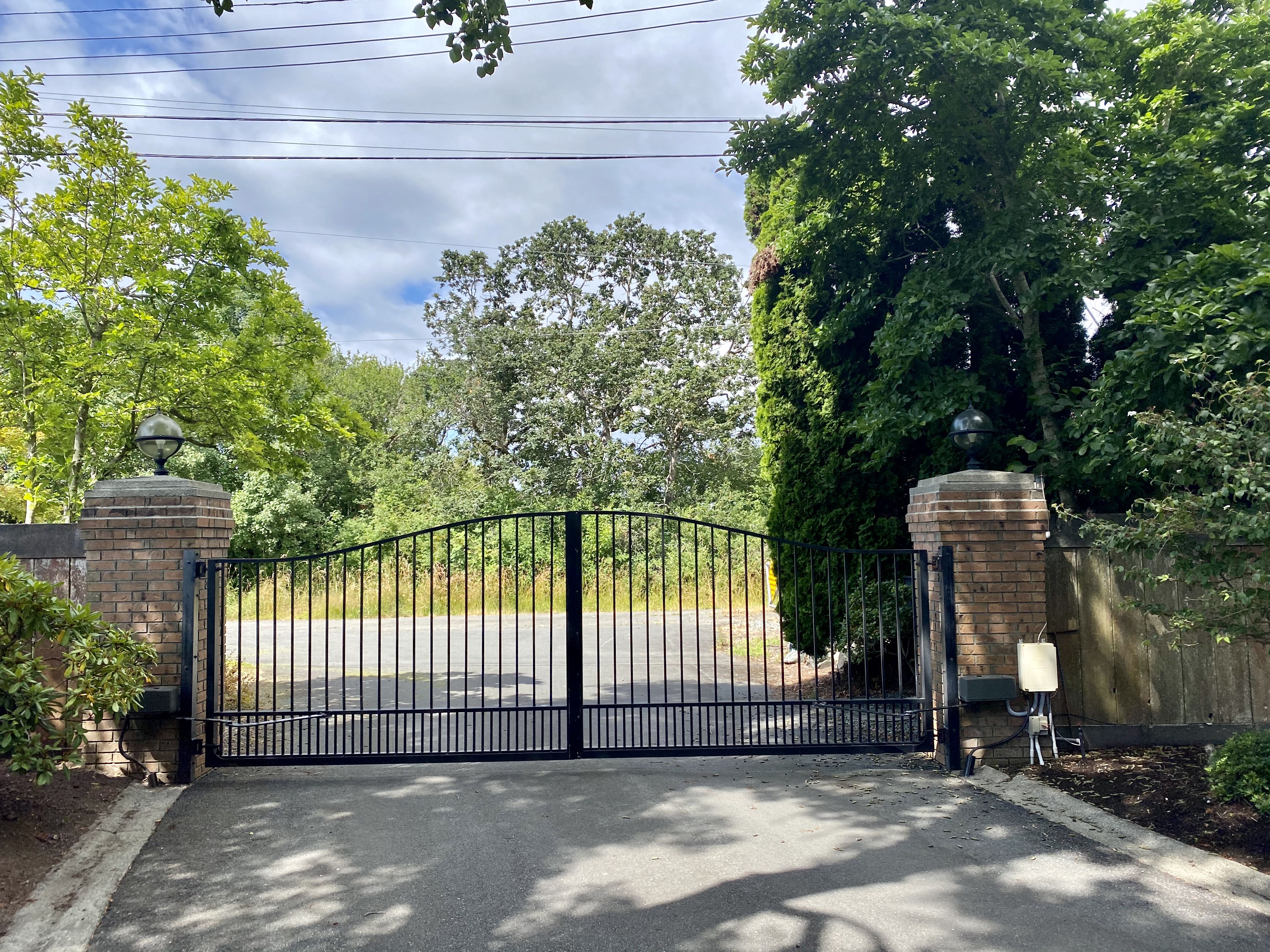

We are tired of the snoopers driving in all the time. We are going to be installing a gate sort of like the one shown. We do have the brick pillars. The gate is just under a 1/4 mile from the house. I will have power and internet at the gate location.
I want the ability to open the gate from a cell phone, pre-program at least 10 codes that will open the gate and I want a key pad where people can punch in the code. I also want video to see who is at the key pad and the ability to talk to them.
If you purchased something similar what did it run you? What brand and model did you get? Are you happy with it? Anything to watch out for or any tips before I go down the rabbit hole? :)
Oh...and how do you handle things like UPS deliveries?

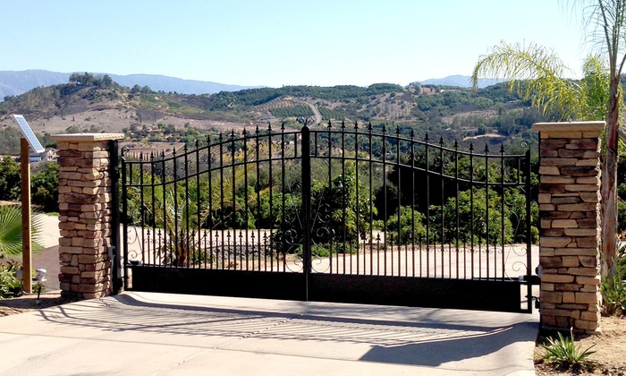

This is the gate I had. I had the slide gate. I did not have all the features you are looking for but they have most of them. Check the bottom of their web page. They stand behind their product.
The Patriot Solar Swing Gate Opener | US Automatic
Don't forget the exit wand and put it about 50 yards from the gate inside the property. That way when exiting by the time you slow roll up to the gate it's opened.
