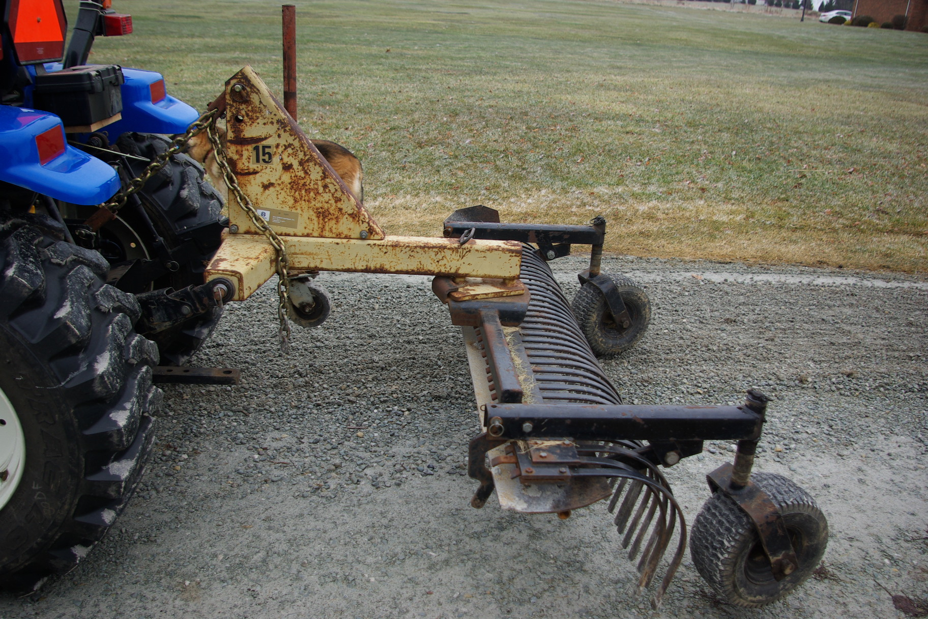

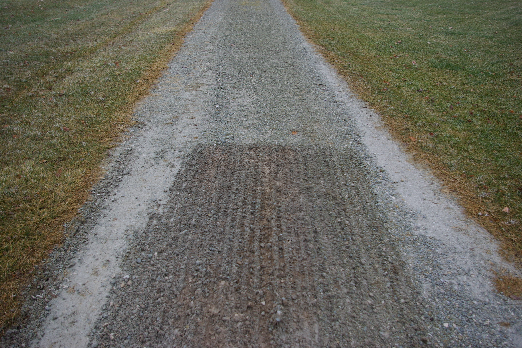

Sounds like a good job for a york rake.
I know a guy whose wife rakes the stone driveway every single day. He parks his log truck on the stone drive but you would never know it.
   / Driveway and parking area maintenance equipment #3
I would also suggest a landscape (York) rake for your gravel maintenance. Frequent use should discourage the weeds and keep your gravel looking fresh.
Thanks guys, I will look into those.
   / Driveway and parking area maintenance equipment #5
I don't really care if my mile long gravel driveway looks "fresh". However - I use my HD rear blade to clean out the ditches and my land plane grading scraper with scarifiers to smooth out imperfections. The LPGS will handle ruts, potholes, speed riffles, etc very well.
I'm a lot more concerned that the surface packs down HARD and allows the crown to shed water.
If not a York rake - a land plane grading scraper should work well.
