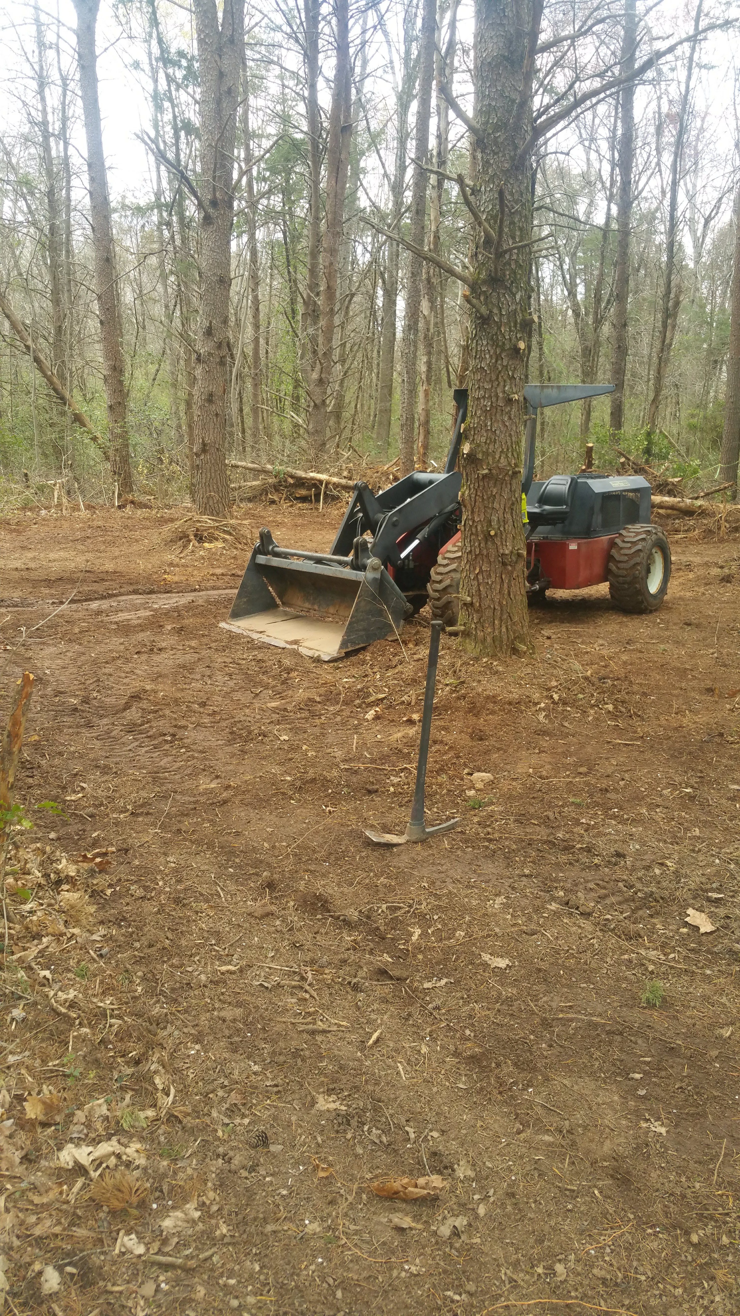

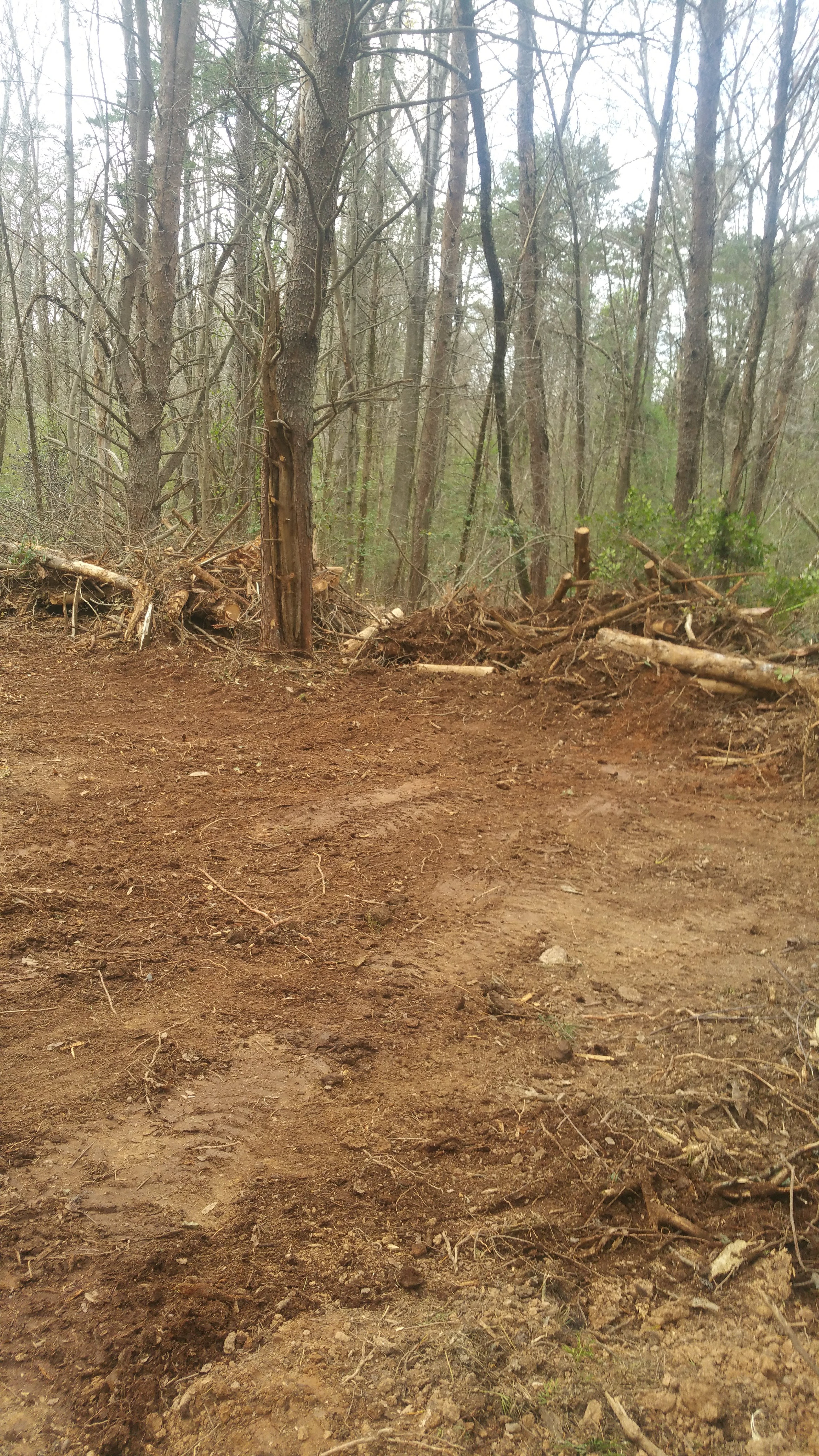

Wel, I am working about 1/2 as much as normal so I have time to work on the driveway and lot clearing for the new shop. My PT1460 machine has plenty of power to push over trees up to about 6-12 inches depending on species. The problem happens with the trees that just bend over and then come back up. Best way to get those out would be the single fork idea to get under the trees and then lift them out. I don't have that tool, so I'm just using a mattax on the small stuff and a sawzall with carbide blade on the medium size stuff.
I have the 4 in 1 bucket and I am able to get the big trees I cut picked up and moved out of the way with no problem. My impression is that if you are considering a 4 in 1 bucket or a brush grapple, I would recommend the brush grapple over the 4 in 1 bucket. I am not having an issue with getting flat tires that I was worried about.
The cleared area in attached photos is about 50 by 60. There are some bigger trees I haven't cut yet at about 2 feet diameter. My thoughts on those are to cut them down and then burn the stumps?

Looks like good dirt...keep updates coming.

You can't hide behind that tree! :laughing:

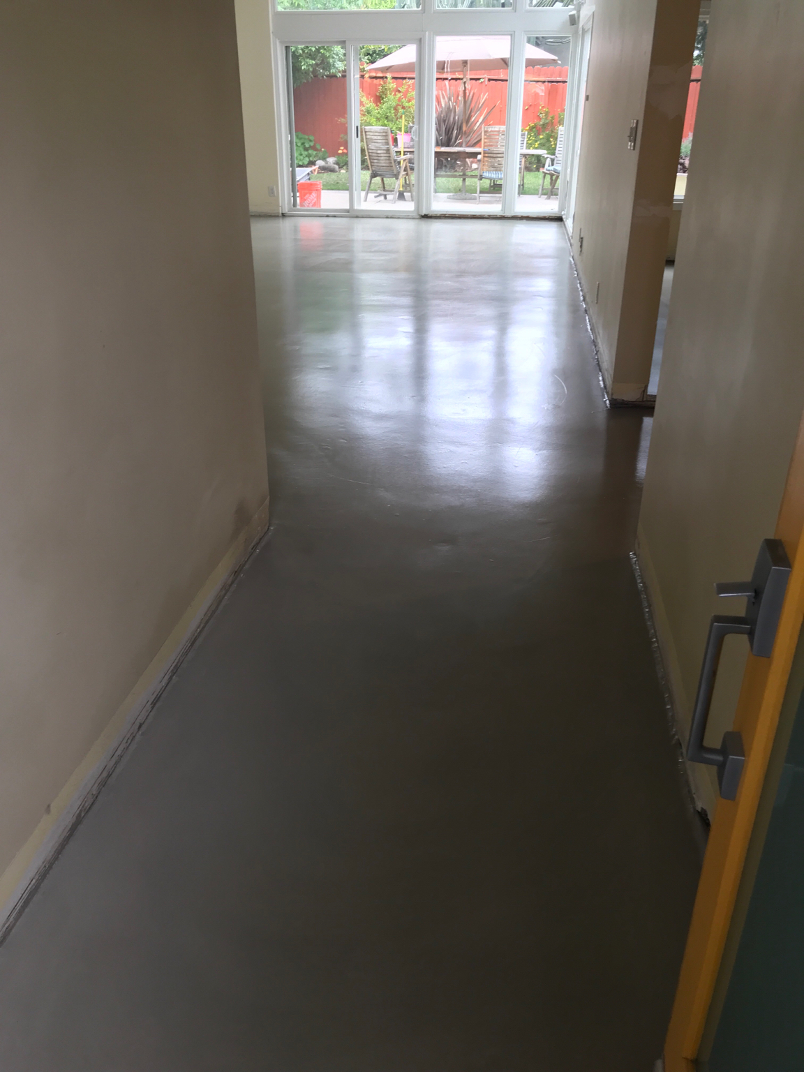

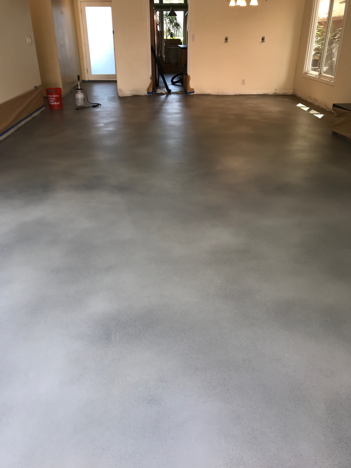

Yup. Big bix stores are open. You have to stand in a line outside 6 ft apart. They hired extra people to manage the lines. As 5 go out 5 get to go in. In la contractors are still working as housing is considered critical. At least for the moment. So new concrete floors are in today. Paint and trim on Thursday. I decided to redo my bbq island and pour concrete countertops and for my first time it came out pretty good. Z-form countertop forms. 60676954160__167FA7E0-5918-427B-B3AF-E4FEA0FD40BA.JPGIMG_9072.JPGIMG_9056.JPG60635635173__F4F481E5-2229-4B9F-BB4D-34CE8D4949A4.JPG
