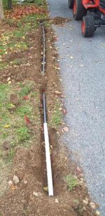

I did some research a few years back on this... My driveway is paved and 1100 feet long. I did not want to have anyone surprise me by driving up without me knowing it.
So, The two options were wired or wireless. Did not want to run a line all the way down so wireless was the way. The next decision was the type of sensor. We have 50+ deer running around this place all of the time so I felt that the motion type would give me a number of false alarms. So, we
went with the metal sensing type.
I went to this site:
http://www.reliablechimes.com/dwa7.htm
and ordered the DW-7-2000. It was close to $500 (OUCH !!!)
But, I must say it NEVER has had a false alarm in the two years that I have been running it. Also, it has never missed a vehicle. It will pick up the tractors and ATV's so you don't need the mass of a car to detect.
Photo attached is the sensor installed along the side of the driveway.
A company called www.supercircuits.com has some lower cost equivalents.
I have no regrets in installing this and I like how it wakes me up at night if someone approaches the house.
