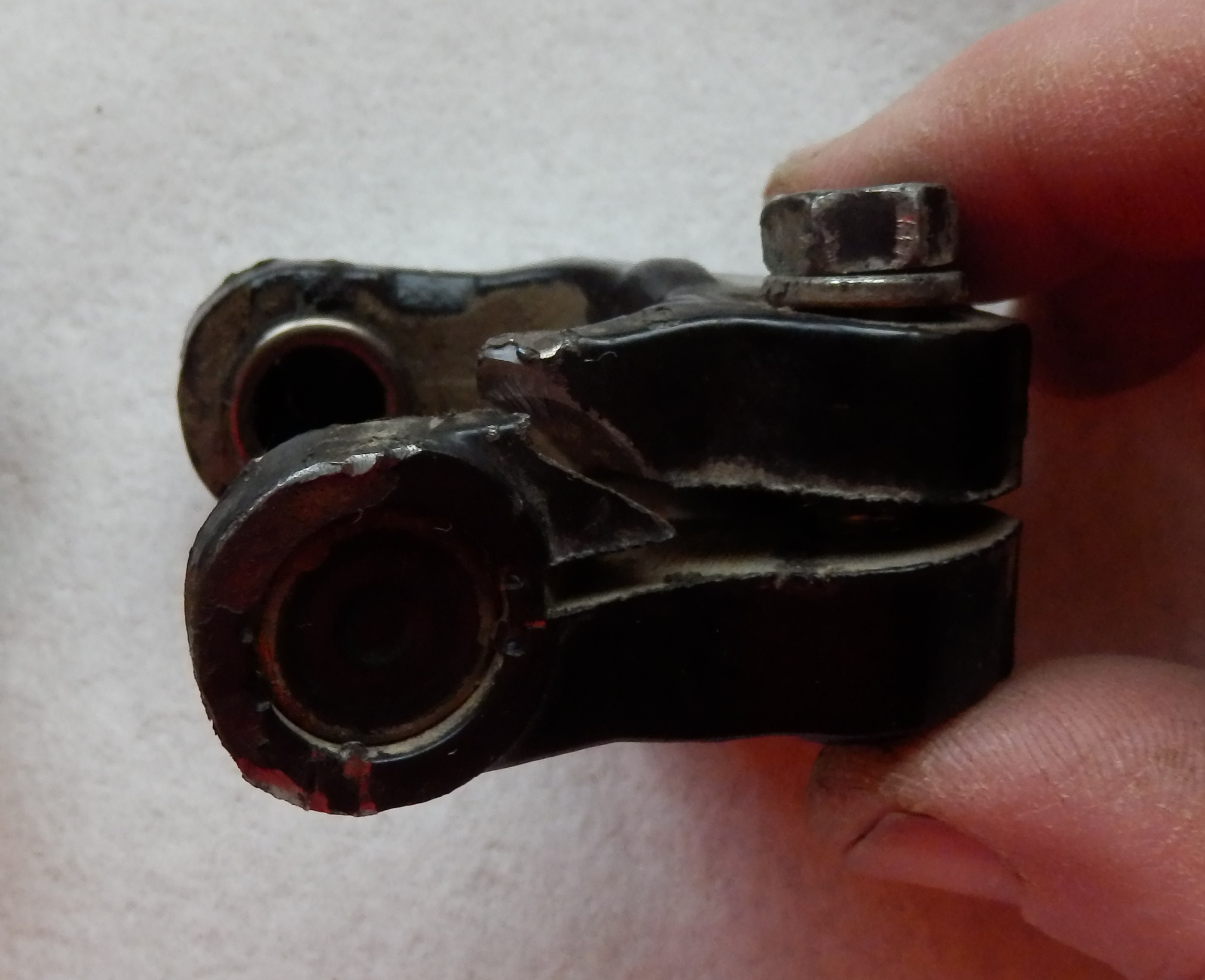

My new style driveshaft on my 273 broke tonight while tilling. U-joint tore out of the rear yoke. Anyone else have this happen with the new style shaft?

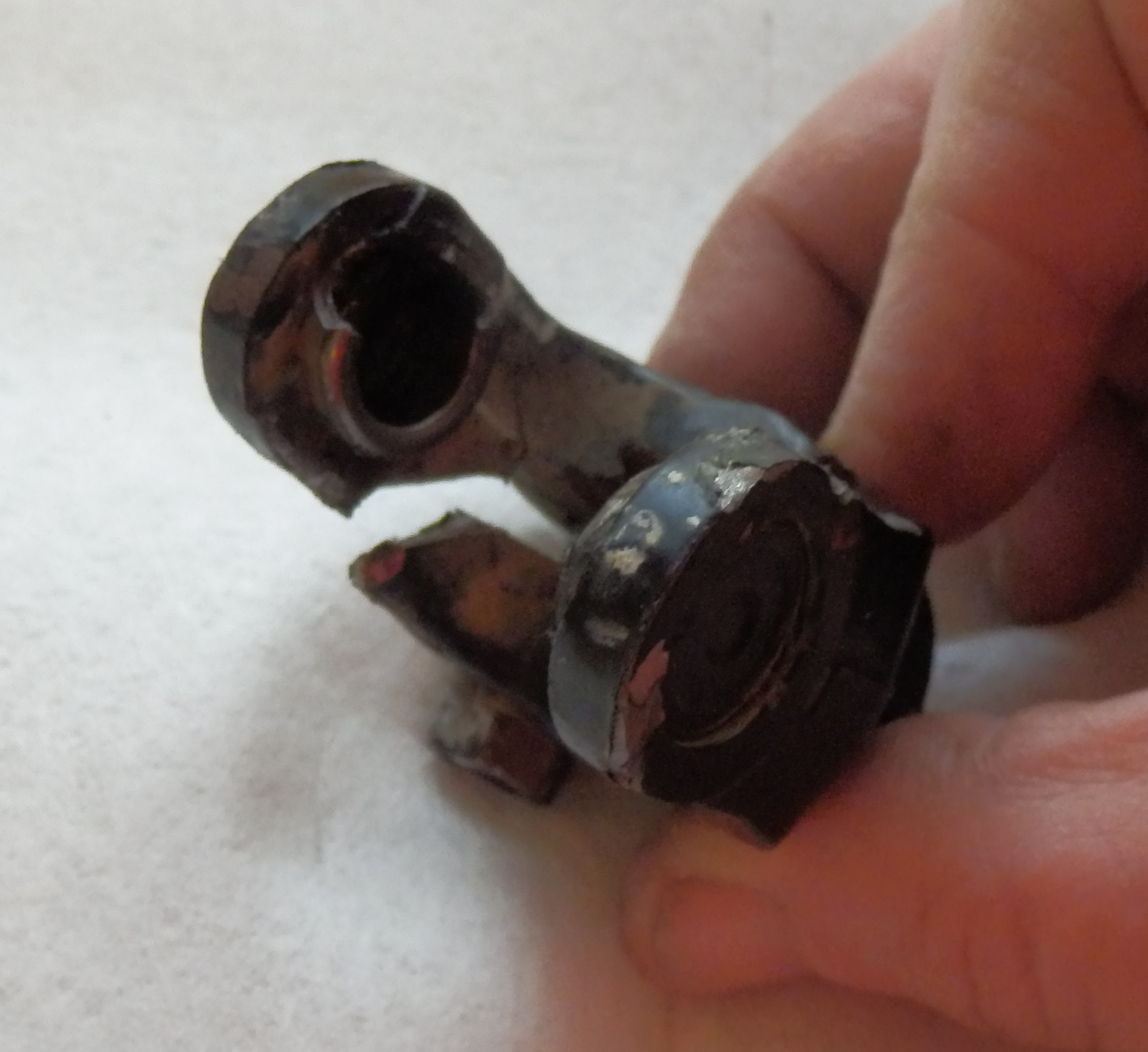

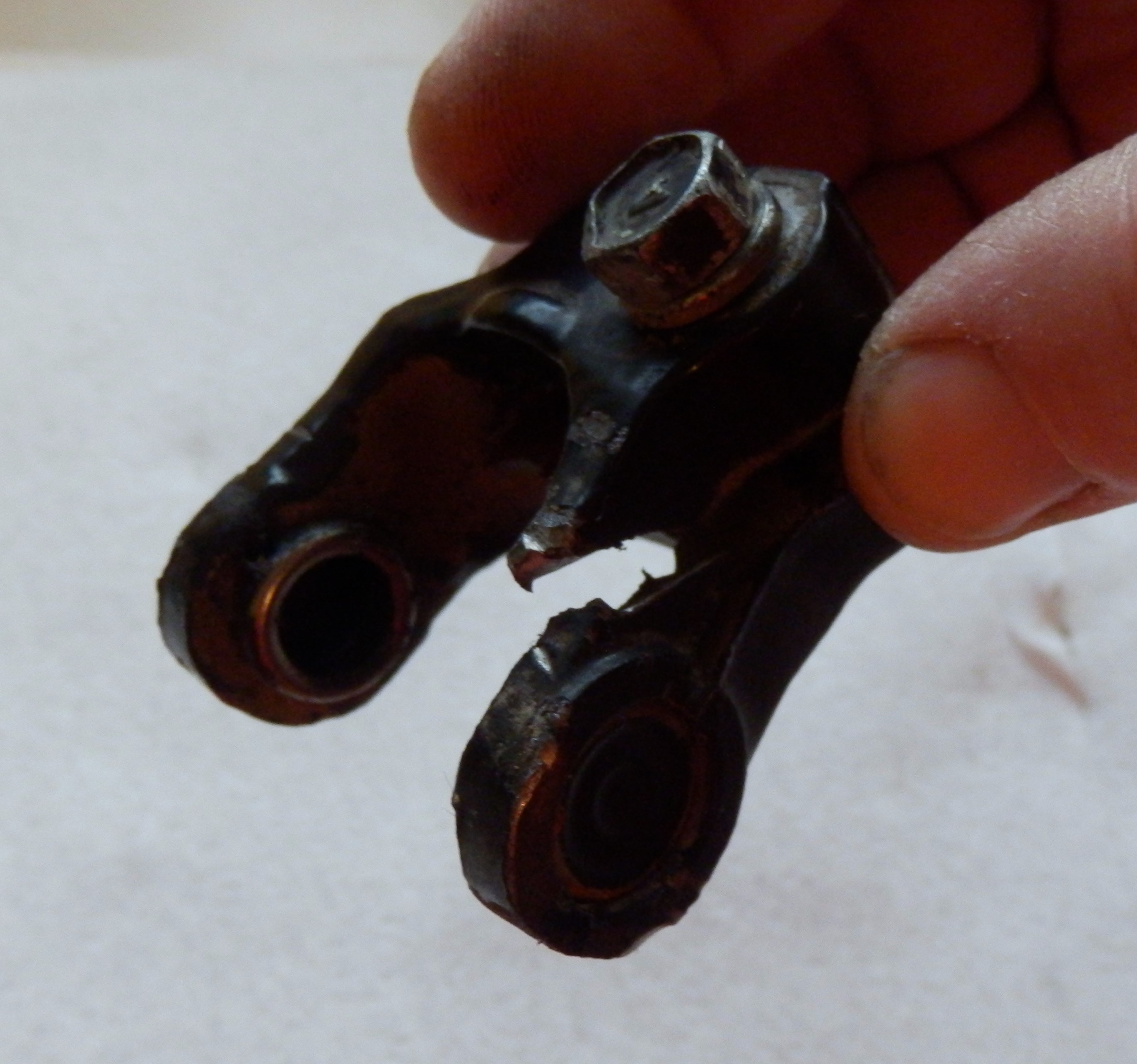

i got the shaft out in about 10 minutes tonight, Here are some pictures. P5120004.JPGP5120002.JPGP5120003.JPG
   / Driveshaft #6
Well glad you are going again but I hope that your case is isolated and we all don't see failures on the redesigned shaft. I am no expert but looking at those pictures really makes we wonder if it was a design or material flaw.

Got the new shaft in place. It comes with out pinch bolt so I used the old ones. Of course 1 snapped probably from over stressed when the shaft broke. So got it out wit an extractor. Will have t0 go to the farm store in the morning for metric bolts.
The shaft is just a little different in design than the last. Nothing that looks like it would be better probably just a different supplier.
One thought I had on why it may have broken. When they had to replace the input shaft on the pump when the first shaft went out and they had the pump all apart. I wonder if they monkeyed with the relief valve and upped the pressure so it is over straining the shaft when to push it to hard. Any thoughts on this theory.
