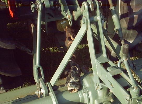

I decided to hook up my tiller for the first time this year, well first ever, and when I started to hook the driveshaft to it, it seemed to long. Can anyone tell if the driveshaft is to long or do I have the tiller attached to the 3 point hitch wrong? I can take more pictures tomorrow if need be.

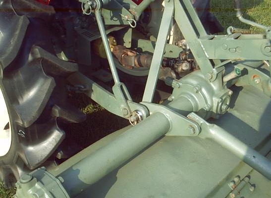

Another picture

Take the OR clutch off. It wasn't designed to have that on.
   / Driveshaft for a Yanmar Tiller
Yep, he's right, you don't need the overrunning clutch to run the tiller. Man I wish that I had a 3 point hitch for my tiller. Sure would make it easier to switch from my bush hog to the tiller. Have fun /forums/images/graemlins/cool.gif
Thanks Reed and Hondo, the OR was the problem. I dont know what I would do without this board /forums/images/graemlins/grin.gif
   / Driveshaft for a Yanmar Tiller #6
Get rid of the overrunning clutch. Also you may find that you will need to attach the PTO shaft first before attaching the 3pt hardware. The tillers set very close to the real wheels that getting a saft on after attachment may not be possible.
