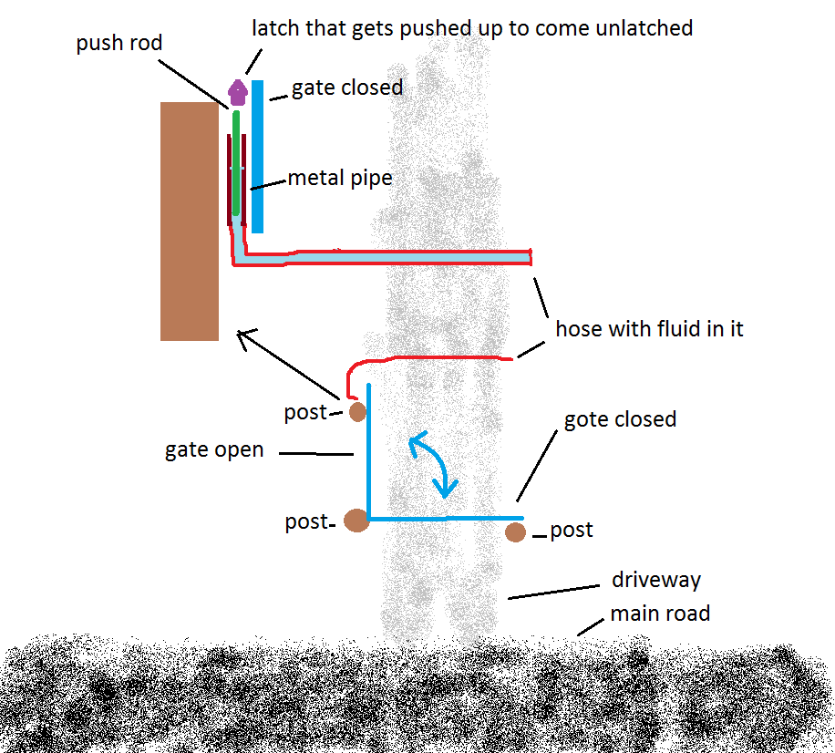

air hose is not filled with actual "air" it is completely full of "fluid" most likely some sort of antifreeze / water mixture. perhaps RV antifreeze. fluid is not compressible, air is. big difference.
**see attach diagram to go with below text**
you will most likely need some sort of bleeder valve on both ends of the hose... to bleed out as much air as possible.
the metal pipe, with push rod = a really small little hydraulic cylinder in all idea.

OK BLAH BLAH BLAH above... change it up for you....
---see if you can find a metal rod that fits nearly perfectly inside of a pipe (rod just a little smaller than inside of pipe.. talking some were in 1/2" rod diameter maybe slightly bigger to make it easier to deal with 0-rings. within reason. ((never done it before, so just guessing at rod diameter.))
---put a couple groves on end of rod, and slip on a couple o-rings. smear some vasaline on. 0-rings to keep them rubber and keep them from drying out, you have a hydraulic cylinder, now.
---attach bottom of pipe to air hose filled with a fluid..

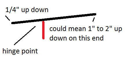

---place rod just below latch, that i can push up. most likely 1/4" difference if that. that the rod might move. might need some sort of lever action. to change 1/4" movement to say 1" movement.
--some were add a Tee (plumbing piece) toss on a valve, and make it so you can easily use a "funnel" to fill things up with water. and bleed air out of the hose. a couple reducers going from say 1/2" up to 3" pipe. can make for a nice DIY funnel built into things.
NOTE: you may need concrete / pavement. or something smooth vs rock/mud for air hose filled with a fluid to work. rock /mud may let the air hose sink down into mud/rock.
NOTE: a larger inside diameter air hose. will cause the DIY hyd cylinder rod to move more up/down.
NOTE: a smaller diameter rod for the DIY cylinder will cause the DIY hyd cylinder rod to move more up/down
